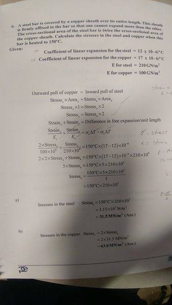

Does this make sense? By the way, the minus sign indicates that the copper is in compression, while the steel is in tension.
Girn261
Please see the uploaded picture, need help understanding a few things. First off, If you look at the equation Strain(c)/E(c)+Strain(s)/E(s) = Ac(delta T) - As(Delta T)
and below that they wrote
2x Stress(s)/100x10^9 + Stress(s)/210x10^9
My question is, how did they go from the top part of the equation, to the bottom? Strain is gone and stress magically appeared. also if you look at the picture I uploaded, the 100x10^9 magically disappears and also they somehow get 5xStress(s)
I wish I had someone to ask for help, but I am stuck and I'm not in school and my co-workers are not very helpful.
Stress=P/area , Strain = coeff. of linear expansion x delta T , modulus of elasticity = stress / strain

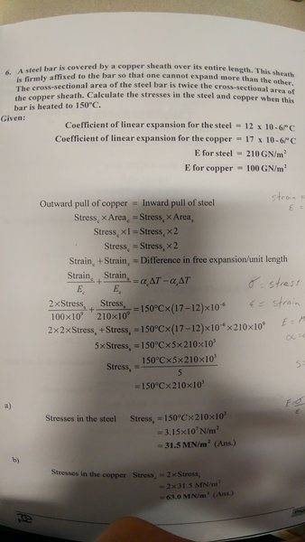

I can't read much of what is on that image . Please post a better copy .
Sorry, hope this helps
I think the equation directly after the Strain_c+Strain_s should read Stress_c and Stress_s in place of the Strains. The units don't even make any sense with what the equation gives. Strain/E does not give a unitless number, but Stress/E would, which matches the other side's unitless answer. I think it was just a simple misprint.
As for the 5xStress_s, they got that from multiplying both sides of the equation by 210x10^9. However, that should give 2.1x2xStress_s+Stress_s, which is 5.2xStress_s. Maybe they forgot the 0.1?

It is clear to me that this problem has not been solved correctly by whomever provided the answer. So, let's go back and solve it correctly. For a rod that experiences a combination of thermal expansion and mechanical strain, the correct equation for the stress is:
$$\sigma=E(\epsilon-\alpha \Delta T)$$where ##\epsilon## is the actual strain experienced by the rod, and ##\alpha \Delta T## is the strain that the rod would experience if it were free to expand unconstrained (i.e., under conditions where the axial stress is zero).
So, for the steel we have: $$\sigma_S=E_S(\epsilon-\alpha_S \Delta T)\tag{1}$$and for the copper we have:
$$\sigma_C=E_C(\epsilon-\alpha_C \Delta T)\tag{2}$$
Note that, in these equations, the actual strain ##\epsilon## is the same for both materials (as indicated by the problem statement). If A is the cross sectional area of the copper and 2A is the cross sectional area of the steel, then the total tensile force F in the bar is given by:
$$F=(2A)\sigma_S+A\sigma_C=0\tag{3}$$Note that in this equation, the tensile force F is equal to zero since the bar is not under tensile load. Eqns. 1-3 can be combined to solve for the actual strain ##\epsilon## of both bars. What do you get (algebraically) for ##\epsilon##?
Likes CivilSigma and Girn261

Thank you I will try that out when I get a chance
I get +26.25 MPa for the stress in the steel and -52.5 MPa for the stress in the copper (assuming the initial temperature of the bar was 20 C). So the copper exhibits a compressive stress, while the steel is in tension. This is because the copper wants to thermally expand more than the steel, so the copper is causing the steel to develop tensile stress, while the steel is holding back, and causing the copper to develop compressive stress.
