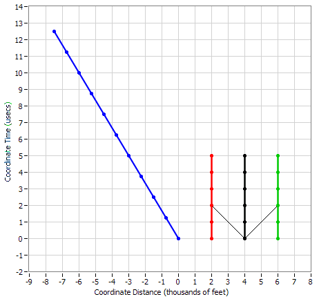

Here's a spacetime diagram for the rest frame of the three spaceships which I have spaced 2000 feet apart in their rest frame. Space ship 1 is depicted in red, 2 is in black and 3 is in green. The middle one has sent a pulse of light to the two outside space ships. The light pulses arrive in 2 microseconds since the outside space ships are 2000 feet away from the middle one and the speed of light is 1000 feet per microsecond. The Earth observer 4 is shown in blue moving away at -0.6c:
thetrice said:
now observer 4 sees them all 3 moving with velocity V , when the event occurred according to him, the light reached to 1 first observer before reaching the third, but since 1st observer recorded a longer time , then time runs faster to him and the third observer will record a time shorter than what should be recorded from fourth perspective so time runs slower at 3rd.
Conclusion from 1st experiment: Time runs slower at 3rd and faster at 1st.

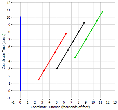

Here is the first spacetime diagram transformed to a speed of -0.6c so that the blue Earth observer 4 is now stationary and the space ships are traveling to the right at 0.6c:
I think what you are noticing is that what took 2 microseconds in the rest frame of the space ships takes 1 microsecond for spaceship 1 (red) and 4 microseconds for spaceship 3 (green) and this is why you came to your conclusion, correct?

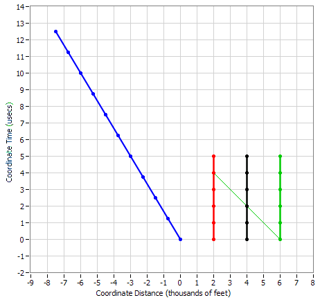

Here's the second experiment's spacetime diagram for the rest frame of the space ships:
It takes 2 microseconds for the light pulse to get from 1 (red) to 2 (black) and 4 microseconds to get from 1 (red) to 3 (green).

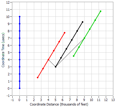

Here's the second experiment's spacetime diagram for the rest frame of the blue Earth observer 4:
For the Earth observer, the times are now 4 microseconds to get to spaceship 2 (black) and 8 microseconds to get to spaceship 3 (green), double what it took in the space ship's frame, therefore your conclusion that time is slower in this case, correct?
