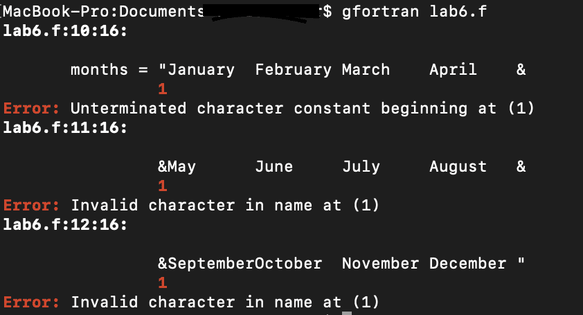

Summary:: so I am trying to compile this program and i keep on getting "Unterminated character constant beginning at (1)" and "invalid character in name" at the months section. what do i have to change to fix it?
thanks
Fortran:

I see nothing wrong, assuming that the blank lines 18 and 20 are not really present. Which compiler are you using?
GNU. And there are no blank lines present. At line 17 i get "Unterminated character constant beginning at (1)" then at 19 and 21 i get "invalid character in name".
I have no problem compiling it with gfortran. Can you show the compile command you are using?
You may have an invisible character, such as ESC, in the source code. How that happened and how you get rid of it I don't know.
this is what it looks like.
The file extension needs to be f90, since you re using that variant of Fortran.
Likes berkeman and jedishrfu
Thanks, it works!

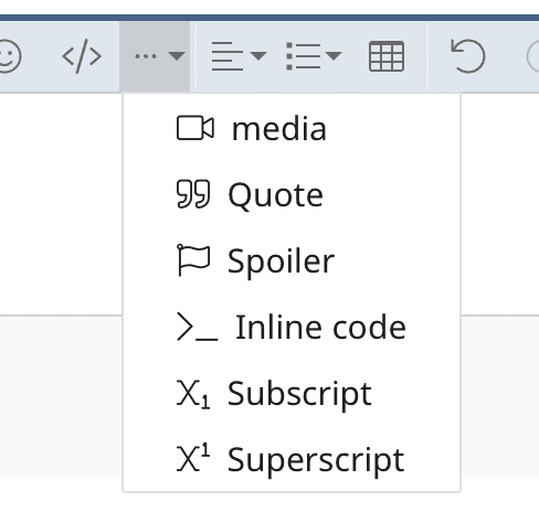

@suezxc6 Please use code tags (>_ Inline code in the dropdown menu) when posting code:
I have also moved the thread to the homework forum.
FORTRAN can be very space and column dependent. You need to use the code tags (see the '</>' tag at the top of the edit window) to keep those exactly like your program code or it will not be possible to get help.
