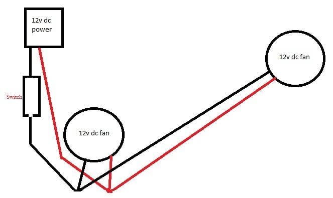

Alright so I have been bored this summer so decided to take apart my electronics such as my Xbox and AV receiver. I installed a nice 12vdc computer fan on the side of my Xbox so I moved onto my AV receiver and then ran into some problems. My current set up consists of:
2x - 12vdc computer fans
1x - regular light switch
1x - 18vdc transformer (from old computer speakers or something)
I understand that I will be running 9 volts to each fan which is not a problem and I have it wired all correctly, *I think*, but for some reason both of the 18vdc transformers I used overheated and stop working whenever I had them switched off. The fans ran fine for 10 or 15 minutes but once I turned the switch off with the plug still in the wall it overheated and would not turn the fans back on.
I am guessing the problem is closing the circuit and backing up the electricity into the transformer causing it to overheat and fail but that is honestly my best guess. Please let me know if you need any other information.

You need to post a circuit diagram.
Here is an attached circuit layout. to the best of my ability.

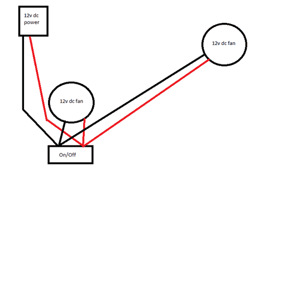

omg! you have placed the switch the wrong. You need to place it in series with the load, not in parallel. Like this
This is new stuff you put in there?
Yeah, that switch is a disaster. It's in parallel with everything, so when you close it it shorts the transformer's secondary, causing massive amounts of current to flow, exceeding the rating of the transformer, overheating it, and likely destroying it or the switch.
Rewire it like IAL said.
Thank you guys. I just noticed that was a really dumb mistake! So in that picture is red positive or is black? And would any of you be able to help me wire it directly into the av receiver if I uploaded a few pictures of the interior?

Since you made that schematic, you must be knowing what is positive and what is negative.
The switch can be placed on either the positive wire or the negative wire no problem.

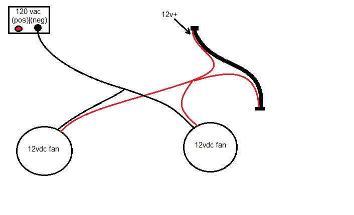

From the schematic I made I made black negative and red positive but when I saw the switch on the black wire in the new post I did not know it was perfectly fine to use either wire. As for the AV receiver I have found a cord similar to the one I hooked my Xbox fan through http://img.diytrade.com/cdimg/1243773/17807402/0/1292828089/XBOX360_DVD_DRIVE_Cable.jpg" but now that I am feeling even less than confident on my circuit abilities I don't know how I would run a correct circuit in order to not burn out my receiver in the same fashion I did my DC converter. Attached is what I think would work for the circuit but PLEASE let me know if I am doing it wrong. The 120vac main power cord is where I would be running the negative wires and that scares me. Also just because it says 12v+ does that mean its dc? Thanks again.

... Attached is what I think would work for the circuit but PLEASE let me know if I am doing it wrong. The 120vac main power cord is where I would be running the negative wires and that scares me. Also just because it says 12v+ does that mean its dc? Thanks again.
STOP!
Your latest diagram is a disaster, and potentially life threatening! Why in the world do you think you should tap into the main 120VAC power??
https://www.physicsforums.com/showpost.php?p=3430088&postcount=4" has a perfectly acceptable wiring schematic.
I urge you, in the strongest possible terms, before you experiment any more with things that plug into the wall, STUDY ELECTRICITY! Here is a very good introduction -- http://www.faqs.org/docs/electric/index.htm. If nothing else, please read the section on electrical safety -- http://www.faqs.org/docs/electric/DC/DC_3.html.

If you are sure you have 12V transformer follow the circuit at Post #4 for the moment. You will be just fine.
Red is +ve, Black is -ve just as in the original circuit.

Alright thanks again for the help. I assumed it would work like my Xbox circuit and the 120vac negative cord would ground the negative wire but I guess that is wrong. I will study up before doing any more electrical circuits. Since I am way wrong about using the 120vac to ground the wire what exactly would I be looking for to ground that negative wire? Sorry for being more than dumb when it comes to electricity.

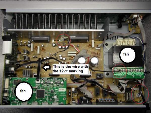

This is the exact AV receiver I own. The wire that I marked 12v+ literally says "12v+" under one of the 6 wires in that cable. I marked the red circles to show spots I THOUGHT I could complete the circuit by plugging in the negative wire. One is the main power cord (this is bad from what you said), the other is the black wire running to the transformer, and the other is a cord that I think is a grounding wire because it ends right against that metal plating. If you do not feel like messing with this project anymore I would completely understand and will go with the schematic that was posted earlier. Thanks.

Can the existing 12V system handle the additional load the fans would put on the system?
If it can't there is a distinct possibility you will sag the 12V rail and possibly cause other problems.
There is no positive or negative with Alternating Current (AC). The ground wire for household AC power literally connects to the ground -- Earth. There is a long metal rod buried in the ground outside your home with a wire connected to it.
Direct Current (DC) circuits often list a "ground", but this is more correctly called a "chassis ground". The chassis ground is almost universally connected to the negative side of the DC power supply, BUT, there are exceptions! Also, do not count on the DC chassis ground being connected to the household ground, especially on devices that do not directly plug into a wall outlet for power.
It is best not to use the term "ground" for DC negative in circuits such as your fans. Using "Positive" and "Negative" prevents misunderstandings and errors.
"Bad" is correct. Leave it alone.
I don't know what the black wire might be. The color of the wire means nothing -- Unless a wiring diagram specifically identifies particular wire colors for particular purposes, DO NOT ASSUME!
Maybe, maybe not! Without a schematic, or at least carefully studying the circuit and measuring voltages, you cannot be certain.

Regarding the notes in the photo, the best I can say is "maybe". The wires labeled "GND" are probably the DC negative, but without a volt meter, it's just a guess.
As mentioned in post https://www.physicsforums.com/showpost.php?p=3431261&postcount=16", there is a good chance that the power supply can't handle the extra load of the fans. Even if it can, it's possible that the systems circuitry will behave erratically with the extra load, or detect it as a fault.

Yes that will work providing that the power supply can handle the load of an additional fan. If it cannot your 12v rail may drop slightly in voltage and your amp may not run properly. Honestly, I don't think you will hurt anything if you stick to using the internal DC supply. Please don't play with the incoming mains power though. Also make sure the case is closed and screwed together before you power it on.
