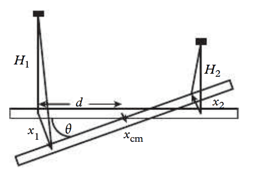

Hi, I'm doing a lab report on the relationship between the period of oscillations in an unequal length bifilar pendulum. The set up is like below
Can anyone help me derive a formula for the period of oscillations so I can plot my data to a graph? thankyou so much

Hi,
Wouldn't that be working the wrong way around ? You plot your data and try to find a pattern to help you find characteristics such as periods (if at all possible -- double pendulums aren't trivial at all !) ?
And: what data do you have ?
Which way are (is) the oscillations ? In the plane of the drawing ?
What does ##d## stand for ?

My teacher told me to derive a formula first and draw a hypothesis from it. Then we would plot our data and make a conclusion
The oscillations are in the horizontal plane, here's a picture of it
d stands for the distance of the points of attachments of the strings to the center of mass
as for the data i have to try this with 5 different lengths

I may appear a little dense here, but: how is that possible ? Do you mean vertical ?
You mean: one of the points (namely H2 in post #1 which all of a sudden is H1 in post #3 :wideeyed: ) ?
What would you plot if H1 = H2 ?
(So far I have no idea what your data consist of)
Did we already clarify what length that would be ? stick length, ##d##, ... ?

Oh right sorry the label was wrong my bad
I wanted to conduct an experiment similar to this but with an unequal length bifilar pendulum

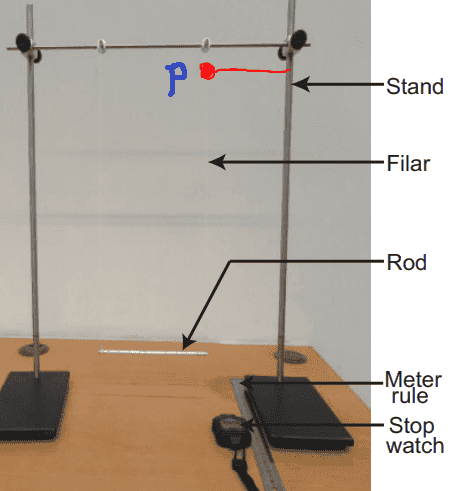

Ah, a picture is gradually forming... I try (not always successfully) to keep an open mind, so it takes a while to focus on the situation at hand :smile: . The link helps (especially the pictures).
Even the simplest case is already riddled with opportunites for hideous complications. Simplest case meaning: L is the length of both wires (H1 = H2 -- hey wasn't that already somewhere ?) and in addition: L ##\gg## r and ##\theta \ll 1##. In other words (as you said), the oscillations occur in a horizontal plane.
All the ##\approx## have to be satisfied !
Conveniently the link gives an expression for ##T## in this simplest case. Were you able to verify their equation (8) ? and to answer questions Q2, 3, 4 ?
And then (now) your teacher (or you all alone by yourself ?) is making life difficult by making ##H_1 \ne H_2##. I can imagine a small clamp on the stand on the right in figure 3 that produces that effect:
So that now point P is fixed and H2 (in post #3 :biggrin: ) is less than H1
As you see I only shortened H2 by a very small amount so that all the ##\approx## can still be satisfied. (In an initial stage I worried about a case like the entire length of H2 ony a few cm and had to shiver...).
Are we still in agreement about the setup ?

My interpretation: 5 different positions of point P. Right ?
And a speculative deduction: you have to try it, so you haven't done it yet ?You could go through the steps of the derivation once more, but my level of abstraction is exceeded already, ...
Maybe split up equation (6) $${d^2\theta\over dt^2} + \left ( mgr^2 \over IL\right ) = 0 \qquad\rightarrow\qquad
{d^2\theta\over dt^2} + \left ( mgr^2 \over 2I\right ) \left ({1\over L_1} + {1\over L_2} \right ) = 0$$ but I don't have a good feeling about it...
so I would have to fall back to experimentation instead of theorizing.

Thank you so much, I didn't know changing one of the lengths would make the whole thing complicated... As for the setup, I was actually thinking of making H1 and H2 have a big difference but is it too challenging to derive a formula for it?
It is for me... :nb)
As soon as you go away from the ##\approx## things become really complicated ...
But it's fun to experiment and explore the limitations ... !

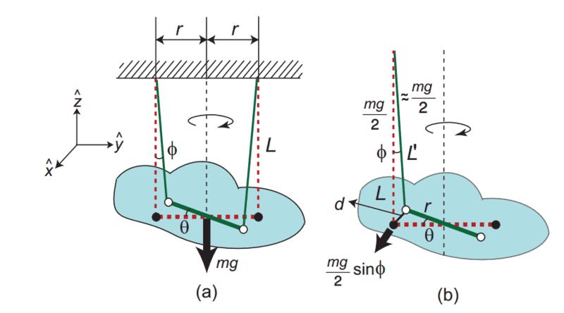

I'm investigating the relationship of mass in the center of a rod in a bifilar pendulum and the period of oscillations.
The equation that I'm using is T = 2π/r √Ll/mg ( sorry I don't know how to type equations)
You can see the equation and how it's derived from this https://www.physlab.org/wp-content/uploads/2017/05/Bifilar-Pendulum-1.compressed.pdf
So I wanted to know if I'm interpreting the equation correctly.
My hypothesis is that the relationship between the period of oscillations and mass would be:
T ∝ √1/m
Is this correct?

It is if the other factors do not depend on ##m## . However ...

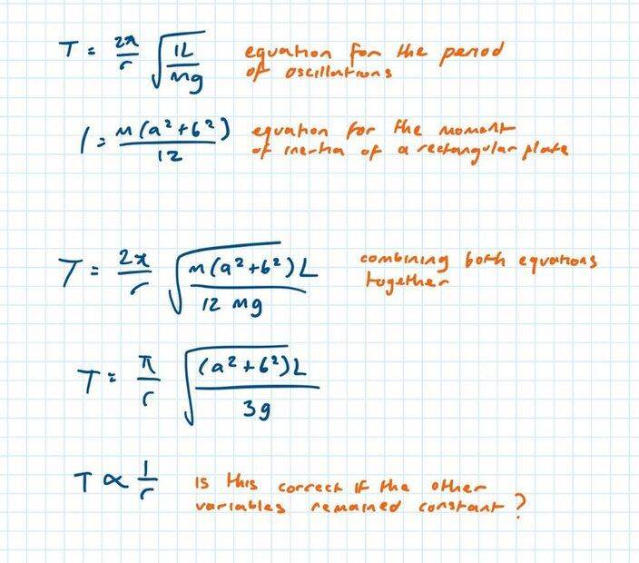

I need to do a lab report on the bifilar pendulum and I'm investigating the relationship between the period of oscillations and r (see in pic).
the diagram is from https://www.physlab.org/wp-content/uploads/2017/05/Bifilar-Pendulum-1.compressed.pdf

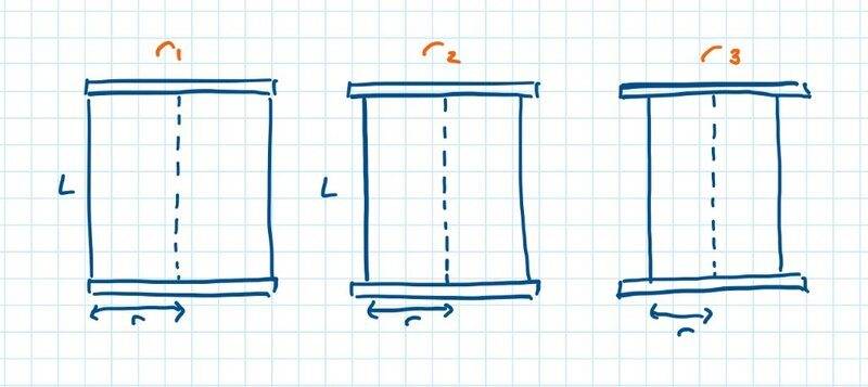

What I'm going to do in my investigation is use 5 different distances for r like this:
I only drew 3 variations of r but later I'll do it with 5 variations
So after getting the data I'll plot them in a graph but I don't know if my equation is valid and here's what I have for now. Since I'm planning to use a ruler as the rod, I substituted the moment of inertia of a rectangular plate to the equation for the period of oscillations like this:

The equation for the period of oscillations is from this: https://www.physlab.org/wp-content/uploads/2017/05/Bifilar-Pendulum-1.compressed.pdf
and the equation for the moment of inertia of a rectangular plate I just googled it
I wanted to ask if the equation is valid for my investigation and if it's correct that T ∝ 1/r. Can anyone confirm this or correct me if I'm wrong? Thank you so much

Yep I can vary it without changing the others but I'm not sure if I can use that equation
Yes I haven't done any measurements yet but I planned on doing it after I got the equation settled
You are right, I should have looked at the sketches a little more thoroughly.
And thus I see nothing wrong in the equation :smile: .
Kudos for your careful advance planning and good luck experimenting !
