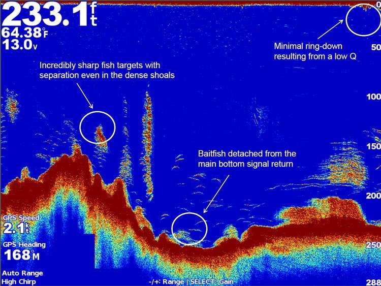

I decided to bite the bullet and install a new sonar in the boat. Something called CHIRP. CHIRP is an acronym for Compressed High Intensity Radar Pulse. Deeper range and better target resolution. It is a sort of spread spectrum technology. I have been procrastinating for a couple of years due mainly to the cost and all the installation issues.
Here is a screen shot of what it should look like.
I hope with the new sonar and the info I can get with the camera/light system I will have a much better chance of finding the fish.

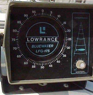

Just curious -- Why do they call a sonar system Radar?

I worked in the seismic industry in the 80's and they used something called naroma, but I think it was basically kerosene,
and would damage many plastics.
