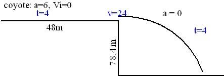

Once again the determined coyote is out to get the road runner. He has a new pair of power skates that provide a constant acceleration of 6.0 m/s^2 along the flat top of the mesa he starts off from rest 48.0 m from teh edge of a cliff just as the road runner zips past towards the cliff at constant speed. a) calculate how long it takes the coyote to reach the edge of the cliff. b) what is his speed as he gets there? c) calculate the minimum constant speed of the road runner in order to escape the clutches of the coyote. d) calculate how far from the cliffs edge the coyote lands in the canyon 78.4 m below. His power skates do not provide acceleration when he is air borne. e) what is his velocity on the cactus laden canyon base when he lands there?

All correct except the (1/2)(6.0 m/s²)(4.0s)² in part (d) should be omitted because "His power skates do not provide acceleration when he is air borne."

d) Calculate how far from the cliff’s edge the coyote lands in the canyon 78.4 m below. His power skates do not provide acceleration when he is air-borne.
Y= y0 + Vy0(t) + (1/2)ay(t)²
Y= y0 + Vy0(t) – (1/2)g(t)²
0= 78.4 m + 0 – (1/2)(9.8 m/s²)t²
0= 78.4 + 0 – 4.9t²
4.9t²= 78.4
t²= 16
t= √16
t= 4.0sec
The above is correct for the time to reach the canyon floor.
x= x0 + vx0(t) + (1/2)ax(t)²
x= 0 +(24.0 m/s)(4.0s)+(1/2)(6.0 m/s²)(4.0s)²
x= 144 m
Why use an acceleration of 6.0 m/s2 ??

What is the acceleration in the horizontal direction when he's airborne ?
Wait, your first solution for (b) was correct!
You can also get it with Vf = Vi + at = 0 + 6*4 = 24.
For (d), the acceleration is zero when airborne:
x= 0 +(24.0 m/s)(4.0s)+(1/2)(0)(4.0s)²
x= 96 m
