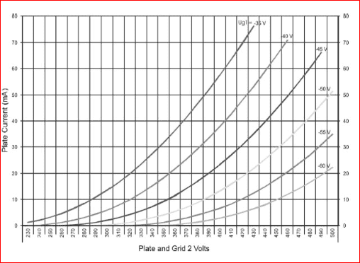

okay you have good screen and plate voltage on 6L6's
so those stages have no obvious excuse to not work
that much negative on control grid says both tubes should be at 10 to 20 ma ooops 20 to 30ma (lost my bifocals) which i think you verified,
sounds to me okay for class AB
https://www.tubesandmore.com/sites/default/files/associated_files/t-6l6gc-tad.pdf
dave and tech have the right idea , inject signal and listen

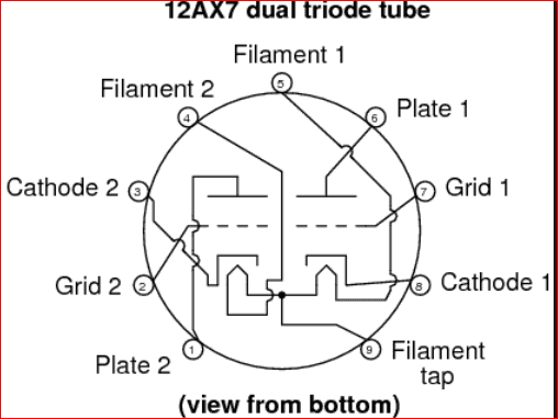

Planobilly said:
plates on the 3 12AX7 250v, 245v. and 280v
each 12ax7 has two halves
i assume you checked all 6 plates ?

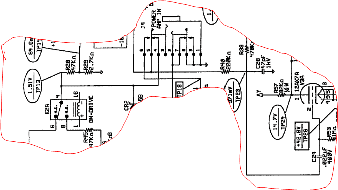

here's a snip from schematic
looks to me per 4.3 tp1 is rms ,
read dc at control grids when you apply signal
does it change much?

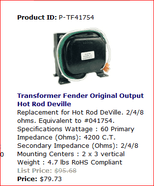

A check of the transformer would be to put a small number of volts across speaker terminals (amp powered down of course) and measure voltages on plate side R-Blue and R-Brown. Hopefully they're well matched.
We don't know turns ratio
so let's assume it's similar to this Hammond 40 watt( God Bless Hammond for staying in the business!)
http://www.hammondmfg.com/1608.htm
sqrt(6600/8) = around 29 to 1, 15 at centertap
shorted turns will show as low turns ratio
hopefully you get close to that result and it's balanced

If you're overdriving those tubes they'll get hot
how much signal are you injecting? How much signal shows at tp24 ?
Aha ! look at schematic I'm still learning my way around it
they show signal voltages on transformer
94primary to 7.8secondary = 12::1 per half
24::1 X 8 = 4647 ohm centertap , maybe it's closer to 30 watt transformer
look for that ballpark impedance and balance

OK..I had it set to pp and will change to rms
R60 reads 220K per the schematic..?
Did you mean R60? that measures 1 ohm and is new as I changed it the other day..this is TP 30 used to measure the bias
read dc at grid 2 pin 4 of the 6l6?
I will read the grid now.
ok 5 volt drop when signal is applied at pin4 6l6 475 down to 470
tp1=3.5mv
tp2=222mv
tp3=
tp4=10mv
tp5=.493V
tp7= 55.1
tp8= 1.2v
I am not sure the relay is working because I am getting low voltage on down the line...think I will change the relay as they area normal failure point in these amps.

Everything is normal until TP5. I will retest at that point an report in a few min.

I now have no AC signal at TP5 pin 6 plate 1 of V1A There is DC 250 or so.
There is the 15mV Ac at TP4 which is grid1...so what could the signal from crossing to the plate? Cathode issue? R11??
I am gona put the scope on the grid and then on the plate...perhaps all that salt are in Key Largo has addled my brain...lol
okay
250 v at plate infers around 1.3 milliamp of plate current, agreeing with their 1.9v at tp12 (which you'll verify)
Put it on the cathode, too .
i don't understand what is the signal comes from U1B through Q2 and C9, looks almost like positive feedback?
but it's controlled by the "more drv" line...
