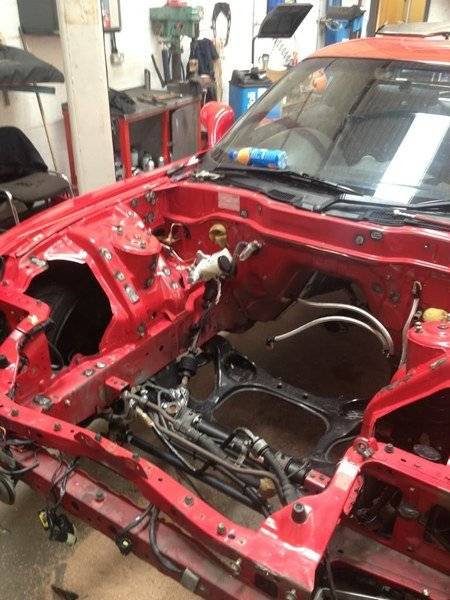

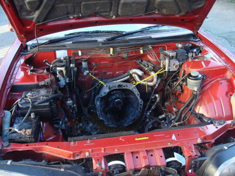

I figured I would post a picture of both car's from the engine side. These are not my car's just a reference from the net. I notice most macpherson strut cars have steel in front of the strut tower, and many double wishbone cars do not i.e 350z along with rx7. Even the older macpherson rx7's have this steel. I have always heard that macpherson cars have a greater load being placed on the strut tower due to the more direct/ localized force path.
s14/ 240sx macpherson strut car
fd3s double wishbone car

Basically two different ideas of what needs done to recreate a shock tower on a tube frame car. I basically just stated that a macpherson car is not used widely in tube frame applications for a large variety of reasons, one being all of the extra weight up high due to needing a much stronger tower. My friend building the car is fully convinced that the force on both towers are numerically the same in the same spot. I realize both cars are seeing the same force entering the chassis (according to my above scenario), I just stated that the wisbone more widely disperses the same load (meaning less on the tower).
He is trying to say since the frame rail is connected to the tower the load is equal on both, but there has to be something accounting for less square inches being affected in the macpherson car.

Im fully with you on that. I basically built my car for something to do. The s14 chassis is a piece of paper when stock, and I needed more room for the engine. My car ended up meeting my goals. The car turned like a jet, and had the most smooth and responsive steering I have felt with it ever.
Here is a picture of the car last year. I realize there are most likely many things on my car that is way less than ideal. I really did not want to do a double a-arm conversion due to my limited understanding of suspension. I basically kept factory geometry and lightened/ stiffened the car. I have had this car for some time so I was able to drive the car before and after the semi-tube frame. I can say I definitely met my goals with the car, I feels amazing compared to before.
I was just trying to get some insight on shock tower loads. I purposely wanted to try and over shoot the durability of the shock tower, due to me thinking a mac-strut car sees a greater load. My friend basically said it does not, it sees the same load. This was my disagreement with him. If I had an rx7 I would have gone a bit lighter on the tower than what I did on my s14. I was able to drop the weight to 2400lbs wet fully loaded of my car. We also jigged the chassis and fastened it down before any cuts were made, pretty important also.
Like I said, I am not trying to justify my car (I know mac-strut is less than ideal), it's what I had, and I got bored. I just wanted to know if my line of thought on the strut tower loads was in the right direction. I just could not see a wishbone car putting the same stress into the tower.
