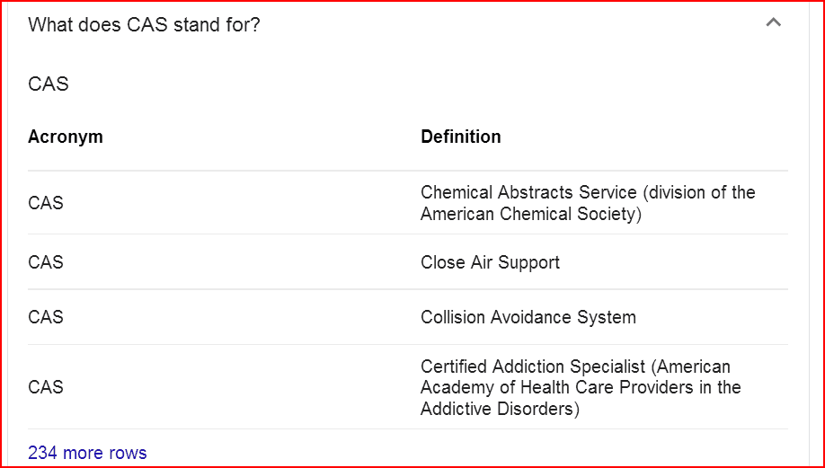

What is CAS?
Google:
CAS = computer algebra system. E.g., Mathematica.
