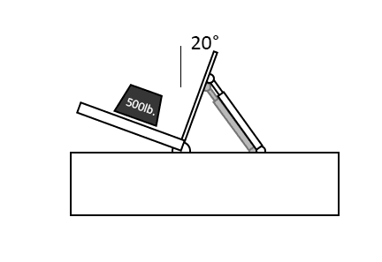

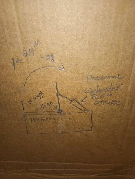

I'm making a device that will use pneumatic cylinders to tilt a 500# load 20 degrees.
I'm making a device that will tilt a 500# load 20 degrees.
Going to consist of a hinged 24" x 24" platform (that the load sets on).
The platform will tilt to the right(clockwise) according to sketch.
The upright post that the cylinder is attached to could be any length.
The cylinder will retract to lift the platform and load.
What would be the most effective placement of the cylinder?
I currently have a couple 2" bore... 8.5" stroke cylinders... will this be sufficient.. or should I use longer stroke cylinders?Thanks much!
I feel that my best bet would be to mount the extended cylinder at a 45degree angle...and go with a longer stroke(Not sure how much longer) but, I'm not sure.
How long are the cylinders themselves? Obviously, you'll have to ensure the extended and retracted length is going to be in-range.

Is the stroke length long enough to get the ideal starting angle?(your sketch looks a bit better than mine... hah... Whatd you use?)
I just Photoshopped it. It's what I do.

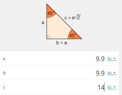

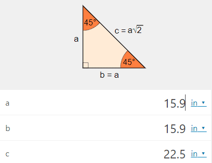

I cannot speak to the engineering aspect; that will have to wait for someone qualified to weight in.
But speaking simply to the geometry, anything between 9.9" and 15.9" will do the trick:
Pulled from this online calculator:
https://www.omnicalculator.com/math/triangle-45-45-90
9.9 to 15.9...Are you saying that needs to be the length from the hinge to where the cylinder mounts to platform?
(And, I guess thatd give the 45degree angle)
Sorry, no. I have not accounted for the range of the piston. It can't be as small as 9.9". That won't allow for any retraction of the piston.
Practically, the best bet is to go with something just shy of 15.9" so it's at almost max extension when load is flat.

(possibly) important note:
When using an air cylinder to retract, the rod area must be subtracted from the cylinder area in the force calculation (a cylinder can push harder than it can pull). Your cylinder can push 315 LB with 100 PSIG air. The geometry in your/Dave's sketch requires a larger force than that (approx 350 LB) to init motion. I think that the cylinder is going to have to be mounted higher / more horizontal (assuming 100 PSI). If you have higher air pressure, you might be OK - need rod size to calc cylinder force.

I was thinking that cylinder could PUSH harder than PULL... And my original thought was to have the cylinders under the platformBut, space and ease of maintenance was an issue with that.So... I had to punt... And try something different.I've been told that plant pressure is 100psi.

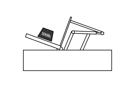

WilliamHerron said:
I was thinking that cylinder could PUSH harder than PULL... And my original thought was to have the cylinders under the platformBut, space and ease of maintenance is an issue with that
It could still be constructed to push. if you make good use of the space to the right of the base; it would just be a little more complicated.
(For illustrative purposes only. I don't recommend this geometry)
