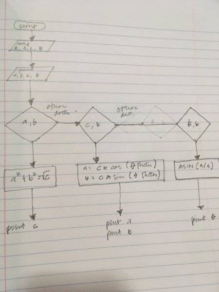

Here's an sketch of my flowchart

I should add that your flow chart isn't helpful at all. Much of it is too small to read, and what I can read doesn't help with actually writing the code. Also, flowcharts are pretty much passe. Very few computer science textbooks use flowcharts any longer -- most of them present the algorithms in pseudocode, which is only loosely defined. Here's a link to some examples -- http://www.unf.edu/~broggio/cop2221/2221pseu.htm.
In the middle you have three diamond shapes. The first has a,b inside it, the second has c,b inside it, and the third has B, b inside it. The diamond shape in flowcharts represents a decision with a true or false answer. "a, b" doesn't lend itself to either true or false.
Going down from the left-most diamond, there is a box that contains ##a^2 + b^2 = \sqrt c##. For one thing, the box shapes are supposed to be used for executable statements, such as print statements, input statements, assignment statements, etc. You apparently intend to do an assignment statement, but your equation is incorrect and it is not an assignment statement, which always has a variable on the left side and some expression on the right side. In your case the assignment statement should be ##c = \sqrt{a^2 + b^2}##, or using Fortran notation, c = sqrt(a**2 + b**2).

Hi, oh well yes I have done already the flowchart but I have no idea how to start to apply the actions in Fortran
The reason for using flowcharts, or better yet, pseudocode, is to get a good headstart on what the code should actually look like.
