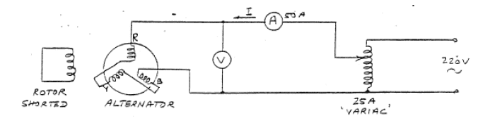

I don't know the method you described. Could you provide a circuit diagram?
Zero sequence impedance measurement of alternator:
Xo = V/3I
I've read that for delta connections, the zero sequence currents are zero on the lines but are present within the phases. Not sure if that applies here
Likes Asymptotic
The stator phases are connected in series (I don't know if that is called 'open delta') in the diagram you posted.
Zero sequence currents do not create a rotating magnetic field. So the reactance offered is largely due to the leakage reactance of the windings. Connecting the windings in series gives rise to three currents equal in magnitude and in phase. These currents are 120 apart in space, so there is no rotating field. To calculate leakage reactance per phase, we use X0=V/3I. If the stator phases were conneted in parallel, it would be X0=V/Iphase.
