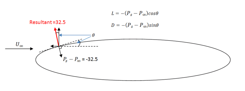

Overall the sum of the forces of drag on an object must of course be negative. But is it possible to have areas of an object that contribute to negative drag?
I have the pressure distribution over a NACA 0015 (symmetrical aerofoil about x-axis) at many angles of attack and I need to calculate lift, drag,etc..
Some of the pressure readings are indicating negative drag at multiple points at multiple angles of attack...unless I am thinking of it entirely wrong..
The picture below (not actual aerofoil!) shows a point on the aerofoil at 0 degrees AOA where the static pressure is lower than the freestream pressure. Does this mean that the resultant force on this point is the red arrow?
And as you can see from the equations this means positive lift and negative drag at this point?

hopefully adding picture now..
You can obviously have a negative "pressure drag" component at certain points along the airfoil, but that isn't the problem here. The problem is that you're confusing the concepts of gage pressure and absolute pressure. The gage pressure is negative, but you still have a "positive" pressure acting at such a point. Since the pressure force is opposite to the outwardly directed unit normal, it is pointing in a direction opposite to that shown in your figure.
Ok, I understand what you're saying about gauge pressure compared to absolute pressure. However, at this point there is a pressure drop due to the acceleration of air around the curved surface. This results in a pressure lower than atmospheric, resulting in a "suction force" on the top surface of the aerofoil. At this point on the aerofoil, the horizontal component of the suction force is in the negative x direction...
or am i still confused..?
You say the resultant is opposite to the one shown in my figure but that would mean that the top surface is contributing to a downforce instead of lift...
As the AoA increases the pressures on this part of the surface become larger and more negative, contributing a large factor of the lift, so I'm not sure about the resultant being opposite...?
Thanks,
Jez
The lift comes from the difference in static pressure on the two surfaces. You can't have a "negative" absolute pressure. The gas molecules impinge on the surface and produce a force directed opposite to the unit normal vector. The first chapter of Anderson's book clarifies a lot of these points.
