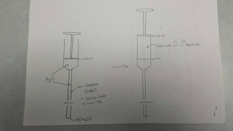

Hello All,
We are trying to convert a vacuum leak test for medical devices (catheters) from a syringe based test to a pump based test.
The current guidelines call for purging air from the ID of the catheter under test with water (~1mL). The distal end of the catheter (tube) is blocked and the proximal end is attached to a 10mL syringe containing 2.5 mL water.
When the syringe plunger is pulled back to 10mL, what is the pressure in the syringe/catheter?
I assume it will change over time as the water evaporates but the test only lasts for 15-30 seconds.
Would the vapor pressure of the water come into play? Would it be 0 mmHg even with H2O present?
Thank you for any information you can provide.
Morgan
15 to 30 sec is certainly long enough for the water vapor pressure to attain its equilibrium value.

I'm having trouble understanding your question(s). Would it be possible to provide a diagram (or diagrams). Thanks.
I hope this helps. We would like to know what the pressure is in the syringe on the right after the plunger is pulled back to 10mL. Please let me know if more info is needed. Thanks again.
Total water volume = ~ 3.5mL (1mL in catheter and 2.5mL in 10mL syringe attached to catheter)
The pressure will be the equilibrium vapor pressure at the temperature of the liquid.
