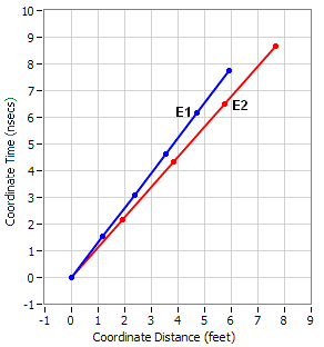

I didn't watch the whole video but I did watch a few minutes prior to your quote and the professor doesn't define which event is 1 or 2. It doesn't matter but you have to be consistent. In his example, he talks about a train car in which two events are generated by a light beams emitted at the center of the car and striking the two ends. Then he considers the train car to be moving to the right and he discusses what an observer on the ground would determine for the delta time between the events. Here is a spacetime diagram depicting the train car in its rest frame. The observer in the middle of the train car is shown in blue and the observer on the ground is show in green. I'm using units where the value of c=1 so I can drop it out of the equations:
The coordinates for event 1 (E1) are:
t1=4, x1=-4
t2=4, x2=4
Therefore, following your preference for ordering the events:
Δx=x2-x1
Δx=4-(-4)
Δx=4+4
Δx=8
Since we want to see what Δt' is for the green ground observer, we note that his speed, u, in the S frame is -0.6c. So applying the formula:
Δt'=-uΔx/√(1-u2)
Δt'=-(-0.6)(8)/√(1-(-0.6)2)
Δt'=4.8/√(1-0.36)
Δt'=4.8/√0.64
Δt'=4.8/0.8
Δt'=6

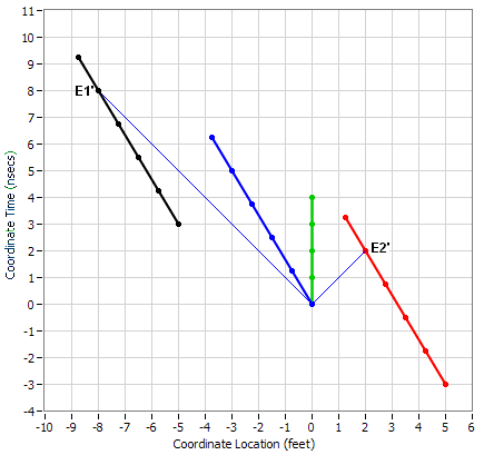

Now to confirm this, we can transform the above diagram into one for the rest frame of the green ground observer:
Sure enough, the primed events are:
t1'=2, x1'=-2
t2'=8, x2'=8
Δt'=t2'-t1'
Δt'=8-2
Δt'=6
You could have interchanged the assignment of the labels for the two events, in which case Δt' would come out to be a negative number, just as it should.
You must have been thinking that u is positive but I hope you can see in the professor's example it is negative.

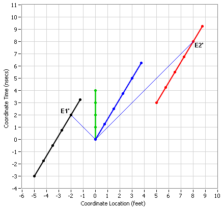

Yes, as long as you continue to maintain the same assignment of labels. Here are a couple of diagrams depicting your new scenario:
And:
But you could even more easily just interchange the labels and gotten a delta with a negative value.
