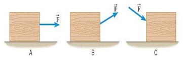

Ignore B & C for now
The block in the figure reaches a velocity of 40 m/sec in 100 m, starting from rest. Compute the coefficient of kinetic friction between the block and the ground.
W = 100N
F = 40 N
2. Homework Equations
∑Fy = 0 so Normal Force = Weight
∑Fx = Force - Inertia - Frictional Force - Weight = 0
0.5 (V^2 -Vo^2) = as
0.5 (40^2 - 0) = a(100m)
a = 8 m/s^2
So I got this equation:
40 N = 100 N ( cos90) + 100N (8m/s^2 / 9.806 ) + 100 N ( μ)
I ended up getting a negative coefficient of friction which is
-0.415827. Is there something wrong with my equation?

The inertia naturally resists the motion so it's negative, frictional force too. Weight is multiplied by the cosine of 90 so it's technically zero. Force appears to be going to the right so it's positive. I'm still having trouble why it's a negative value when computed

I see a couple of problems with this equation.
1. You say that the net force (sum of all the forces) is zero. That is true only if the acceleration is zero. This is not true here because the block starts from zero velocity and reaches 40 m/s some time later. Therefore the acceleration cannot possibly be zero.
2. You show 4 forces acting in the horizontal direction. I can only see 2 that make sense, "Force" (pushing the block) and "Frictional force" (from the ground contact). Where does "Inertia" come from? What about "Weight"? Is that in the horizontal direction?

Actually, your first answer of μ = -0.416 looks like it was correct. But I could not understand your method. It seemed like there were some problems.
For example, if you could explain how this equation came about.
Look, if the contact were frictionless, the acceleration would be
$$a=\frac{F}{W/g}=\frac{40}{100/9.8} = 3.92~m/s^2$$
How can the acceleration with friction be about twice a much? If the numbers are copied correctly, they are not thought out correctly.
Actually, the more I look at your equation, the more it makes sense. The only thing that is really questionable in that equation is the 100cos90 term. Where did that come from?
One other tip: It is best to leave out units in these equations. Just include them in the final result.
If I throw out the 100cos90 term in your equation, I am left with:
40 = (100)(8/9.8) + 100μ, which is derived from:
ΣF = ma
F - f = ma (where F is the 40 N applied force and f is the friction force)
40 - μ(100) = (100/9.8)(8)
Solving gives μ = -0.416.
So I think you were pretty much on the right track, except for that 100cos90 term.
