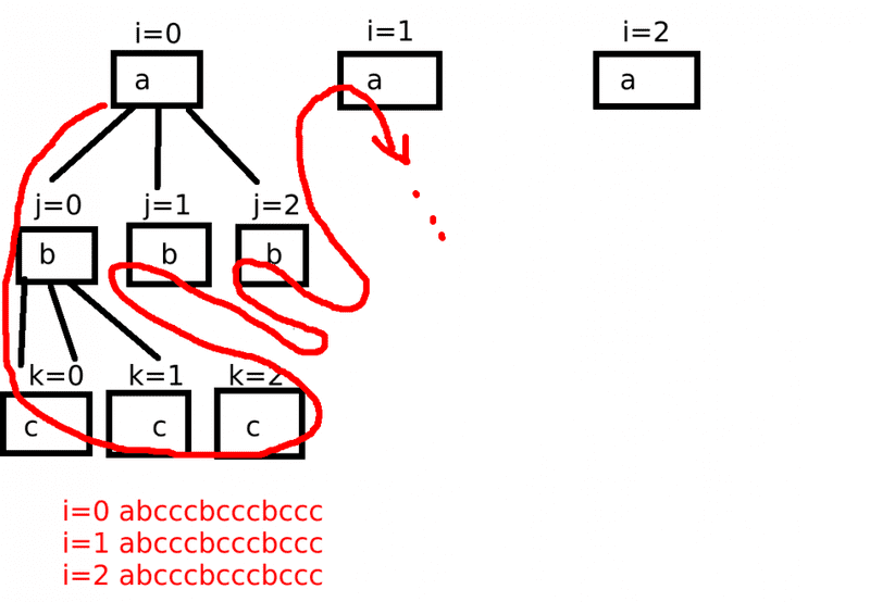

you can also try to make a tree with that? it can help you imagine what goes on... it would look like this
late347 said:
for some reason the program reverts back to the b loop (for some reason, why is this so I am having trouble here?)
I guess the easiest way to understand this is by having in your mind that once the program sees a "for" it goes all about finishing whatever is within it before returning and going to the next step of iteration or leaving out... you go into a-loop - you have to iterate and finish everything within... when you enter you see the b-loop - again you have to iterate and finish everything within... when you enter you see the c-loop - you finish everything and iterate over it... c-loop finishes iterations and goes out, b loop can continue iterating...and so on and so on.
For that reason you don't return to the 1st for, but to the 2nd... (because the 2nd is met within the 1st and it is not over yet)... that's why sketching it as a tree can help you (move up only once you finished everything in a line, starting from the top left to finish on the bottom right as I sketched it)
