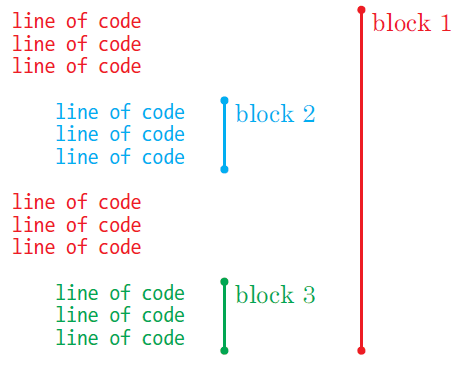

In the figure below, as far as indentation, the red statements are all in the same block (block 1). Block 2 and block 3 are different blocks even if they have the same indentation. They are both part of block 1.
Fundamentally, what does it mean for certain statement to be inside the same block? It is not about what gets executed first or after other statements, I think. I get that lines of code in the same block "go together" but I am not completely sure what that really means.
In this next example, the situation is different:
[Note that I conquer that I made an error in my previous post and the last line do need an indentation.]
