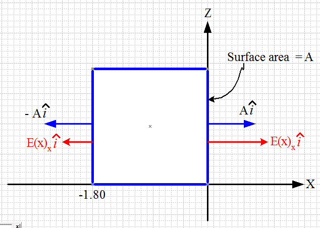

Close. You need to set the sign of the area element so that the vector representing it is leaving the cube. You've attributed a positive sign to both area terms. How can that be? One face faces the +x direction, the other the -x direction.
I think I see what you mean - since the field leaves the cube from the yz square at x=0:
Σq = ε0 * ((2.86x + 3.82)*(1.8)^2 - (3.82)*(1.8)^2)
Σq = ε0 * (-4.30272 - 12.3768)
Σq = ε0 * (-16.67952)
Σq = -1.4768E-10
This makes more sense, actually - what do you think?
Yes, the field leaves the cube at the x = 0 face. So both the area vector and the x-component of the field there should have positive values, as the area faces outward along the +x direction.
At the other face, where x = -1.80, the field also is leaving the cube. The area vector there should point along the negative x-axis, and so should the field component (which it does as the x-component is negative there). That is, both will be negative, so that when they're multiplied a positive value results.
Both faces should yield positive values for the flux, since flux is leaving both faces. Looking at the cube from the point of view of the negative y-axis:
##E_x## is positive when x = 0, and negative when x = -1.80.

You need to compare the directions of the area and field vectors to see if the contribution is positive (leaving) or negative (entering). Always make a sketch of the vectors at the surfaces. So your result now is correct.
That actually makes sense, since the flux comes from within the cube. I'm not sure if that's what you were getting at, though.
Yes, that's what I was pointing out. Note that in some other situation one of the fluxes might have been entering while the other was leaving. You need to always compare those vectors!
