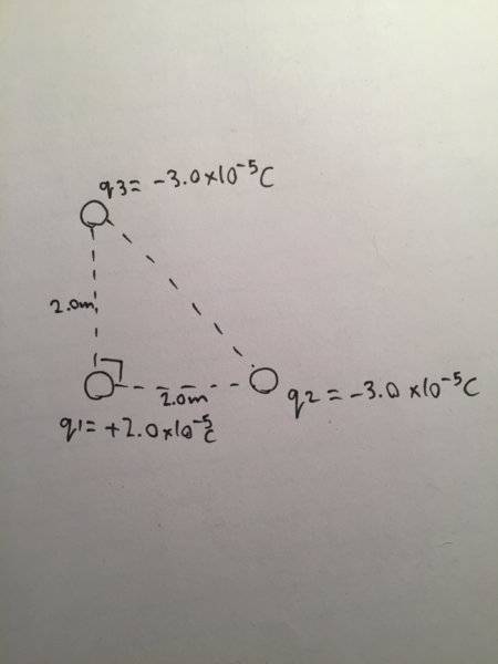

A) Determine the net force on charge 1.
B) What is the net electric field acting on charge 1?
Fnet
Enet
Let North and East be positive.
Because of symmetry, F21 = F31
F2 = F3
F2 = (9.0x109)(2.0x10-5(3.0x10-5) / (2.0m)2
F2 = 1.35N
Fnet = √1.35N2 + 1.35N2
Fnet = 1.909N
Fnet = 2N
For the angle of the electric force:
tan-1 = 2/2
= 45º
therefore the net electric force on charge 1 is 2N [N 45º E].B) Enet
Let right and up be positive.
r = √22 + 22
= 2√2
Enet = 2E1cos45º
Enet = 2(kq1 / r2 cos45º
Enet = 2(9.0x109)(3.0x10-5) / (2√2)2 cos45º
Enet = 47729.7 N/C
Enet = 4.7 x104 N/C
Any input is appreciated as I still am not completely confident that I am doing these questions right. Thanks​

The force calculation part is correct but I don't get what you have done with the electric field. I think there is a problem with your notation, electric field ##\vec{E_{1}}## due to ##q_{1}## at the location where ##q_{1}## is located will be infinite, you don't have to consider charge ##q_{0}## in the evaluation of electric field at that location. The electric fields of ##q_{2}## and ##q_{3}## will add according to superposition principle. Use the definition of electric field , ##\vec{E} = \Sigma\vec{F}/q_{0}## , to calculate electric field at the location of ##q_{1}##.

Recall the definition of the electric field strength: it is the electric force acting on unit positive charge.
You need the electric field at the position of charge 1, which is simply the electric force acting on the charge 1 divided by q1. E=F/q1.

So
Enet= F/q1
= 2N/C/ 2.0x105
=100000
The net electric field acting on charge 1 is
1.0x105N/C
chef99 said:
So
Enet= F/q1
= 2N/C/ 2.0x105
=100000
1.0x105N/C
OK, but what is the direction of the net electric field?
would I state: The net electric field acting on charge 1 is 1.0 x105N/C [N 45º E] --as I have already determined the direction of the electric force or would I have to calculate it differently for the electric field? i.e. is the direction of the electric field the same as the electric force?
Yes, as the charge q1 is positive. If it was negative the direction of the electric field would be opposite to the force.
Thanks
