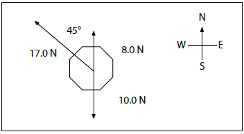

Calculate the net force acting on the object indicated in the following diagrams. Show your work.
1)
2)
[/B]
1)
8.0 N (north) + 10.0 N (south)
- 8.0 N (south) + 10.0 N (south)
= 2.0 N (south)

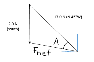

c= [ (2.0 N) 2 + (17.0 N) 2 - 2 (2.0 N) x (17.0 N) cos 45° ] 1/2
c= 15.6 N
sinA/2.0N = sin45°/15.6N
A= 5.2°
A= 45° - 5.2° = 39.8°
Fnet = 15.6 N [N 39.8° W]

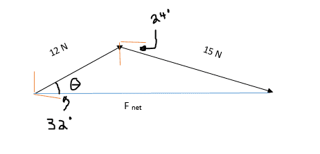

c= [ (12 N) 2 + (15 N)2 - 2 (12 N) x (15 N) cos124°]
c= 23.9 N
sinA/15N = sin124°/ 23.9 N
A = 31°
Fnet = 23.9 N [ N 31° E]

In 1, you do not show a diagram for the triangle of forces, so I'm not sure what your angle A is. You seem to have used it inconsistently, leading to the wrong answer for direction of force.
In 2, the angle you found is not the one you want. It seems to be the angle between the resultant and the 12N force.
Can you post your force triangle diagrams?
1)
Here is the diagram for 1) :
I corrected my answer for 1) :
-8.0 N (south) + 10.0 N (south)
= 2.0 N (south)
c = [(2.0 N)2 + (17.0 N)2- 2 (2.0 N) x (17.0 N) cos 45°]1/2
c = 15.6 N
sinA/a = sinB/b = sinC/c
sinA/2.0 N = sin 45°/15.6 N
A = 5.2°
45° - 5.2° = 39.8°
Fnet = 16 N [ W 40° N]
is this better?
2)
Here is the diagram for 2):
I also corrected my answer for 2) :
c2 = a2 + b2 - 2abcosC
c = (a2 + b2 - 2abcosC)1/2
c = [(12 N)2 + (15 N)2- 2 (12 N) x (15 N) cos 124°]1/2
c = 23.9 N
sinA/15 N = sin 124°/ 23.9 N
A = 31°
32° - 31° = 1°
90° - 1° = 89°
Fnet = 24.0 N [N 89° E] or 24.0 N [E 1° N]
better?
Evangeline101 said:
1)
= 2.0 N (south)
c = 15.6 N
A = 5.2°
45° - 5.2° = 39.8°
is this better?
Looks right.
Edit: the angle might be a bit inaccurate. Retry it keeping more significant digits at each step.
Doing it a slightly different way (using arctan) I got about 42 degrees.
Evangeline101 said:
2)
c = 23.9 N
A = 31°
32° - 31° = 1°
90° - 1° = 89°
better?
yes, but again the angle could be a touch more accurate.
Ok, I will keep a few more significant digits to make the angle more accurate. Anyway, thanks for the help :)
