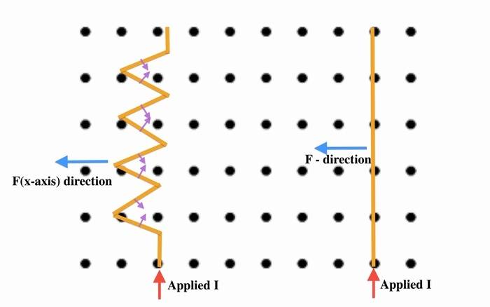

Net Lorentz force, of a non-linear wire.
In summary, the diagram shows two types of wires, a straight wire and a non-straight wire (zig-zag shaped wire), both placed in a magnetic field and with current flowing through them. The straight wire experiences a force towards the left, while the zig-zag wire experiences a force at an angle perpendicular to the current flow, depending on the angle of the wire. The force on the zig-zag wire can be calculated using the formula F = IL x B, but it will be less than the force on the straight wire due to the zig-zag wire's shorter length. The wires are assumed to have the same length and current flow, but it should be noted that if the wires are connected to a constant voltage source,
PhiowPhi
203
From the diagram above, there are two types of wires a straight wire and a non-straight wire(zig-zag shaped wire), that are both placed inside a magnetic field(B), and have current flowing in both of them as well. The straight wire will experience a force and will move towards the left as marked(F-direction), while as the zig-zag wire will have the force dependent on the angle and Lorentz force, since there are a couple of bends on the zig-zag wire, there will be a force at an angle perpendicular to the current flow,as marked(purple arrows), the y-axis of each bend cancels out with the upper wire only leaving the x-axis remaining. Correct?
Depending on the angle(in degrees) the force on that zig-zag wire would be:
$$F = IL \times B$$ - which is the same as the straight wire, however , $$F_z = F_L \times \cos(x°)$$Where [tex] F_L [/tex] is the Lorentz force of the zig-zag wire, and [tex] F_z [/tex] is the net-force of the zig-zag shaped wire's x-axis if the angle is known.
Is this correct? I don't think the second wire is equal to the straight wire, because there are some opposing forces that cancel each other out(y-axis) due to the current flow being opposite, and leaving some force remnant that is the x-axis.
**NOTE:** Both wires are the same in Length, and have the same current flow, and placed in the same magnetic field.
That is an interesting problem. I don't know the answer immediately. What I would do is to simplify the problem. Calculate the force on one zig zag, and see if that differs from the straight wire. I suspect that it will.

It really is, I've been trying to figure this out for a bit. I initially assumed that it would be non-equal to the straight-wire. In fact, it should be less.
I broke it down one by one to calculate each individual zig-zag's force. But what I'm not sure of is the length equal to the wire like so:
Just the right side vertical red line.
OR:
That red line, blow the wire being the length for the Lorentz force, I assume it's the first one above.
The angle of force of that individual wire seems to be at an angle 60 degrees, or possibly less?
I should then add up the x-axis forces since the y-axis cancel out(because the current flow is in opposition).

I would not assume equal lengths of wire, I would allow the length of each to vary and see what effect it has on the force. It may be that the force cancels out for equal lengths but not for unequal lengths.
I would also do this for an arbitrary half-angle. However, there's something else to consider - are these wires connected to a constant voltage source or a constant current source? If the former, there will be less current flowing through the zig-zag.
Same net force.

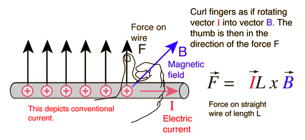

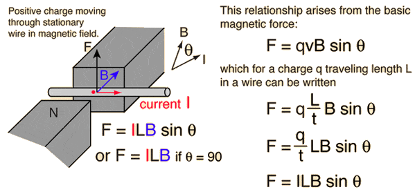

it wasn't clear to me whether the force on your wire is the force resulting from current flowing in the wire,
or is an externally applied force causing the wire to move.Take a look here: It's one of those little confusing points:
http://hyperphysics.phy-astr.gsu.edu/hbase/magnetic/forwir2.html
Aha we're in luck - velocity and charge resolve to current !
So if you're figuring force resulting from current,
Aha - if the wires are same length
then the zigzag structure must be not so tall as the straight one, unlike your sketch...
So, your zigzag spans less vertical run than the straight one;
hence cuts fewer lines of flux,
so experiences less force from the same current.
am i on right track?

I'm not sure how to figure out or "measure" lengths properly for such a wire. It's true that the zig-zag wires are longer and have "more copper" if that makes sense.
But I was curious specifically for equal lengths, wanted to see the effect if they we're equal, why might equal lengths cancel while as non-equal lengths do not?

Could you explain why? I disagree.
jim hardy said:
Hmmmm
Ops, sorry for not clearing that out, but it's from a current source(CCS to be exact).

Well, I was not sure how to "measure" length properly. Therefore, sketched it to be the same as the vertical wire, but indeed it seems to be un-equal.
I must take the same length as the straight wire then form the zig-zag shapes.

I believe so, I'm somewhat on the same track(aside from the confusion of lengths). And yes, the arrow are based on the right hand rule and QVcorssB.

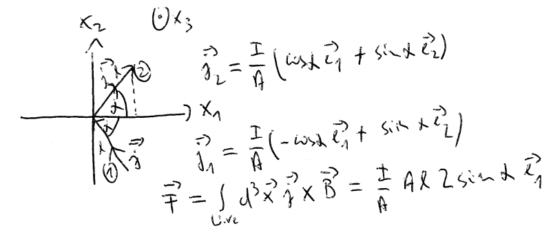

I don't know, whether I understand the drawing in #1 right. Usually the dots indicate a vector pointing out of the plane, and if this is the magnetic field and the arrow labeled ("applied I") indicates the direction of the current density then the force should be to the right, not the left.
Now we need to clarify some very important basics: A current is a scalar and thus has no direction. Its sign is determined by the choice of the orientation of the crossectional surface it runs through and the current-density vector:
$$I=\int_{A} \mathrm{d}^2 \vec{f} \cdot \vec{j}.$$
The current density is a vector, given by ##\vec{j}=q \vec{v}##, where ##q## is the charge of the particles making up the electric current density, i.e., usually electrons in a usual metallic wire and ##\vec{v}## the flow-velocity field of these charges.
Now to the problem with the zig-zag wire. I think it's a good idea to look at the one zig-zag piece drawn in #7. So let's set up this problem a bit more carefully: We use a cartesian coordinate system with the ##x_1##-axis pointing to the right, the ##x_2##-axis pointing up in the paper plane and the ##x_3## axis pointing out of the paper plane, so that we have righthanded Cartesian basis, ##\vec{e}_1 \times \vec{e}_2=\vec{e}_3##.
Now the current density in the lower piece of the one zig-zag piece is
$$\vec{j}_1=\frac{I}{A} (-\cos \alpha \vec{e}_1+\sin \alpha \vec{e}_2)$$
and the upper one
$$\vec{j}_2=\frac{I}{A}(\cos \alpha \vec{e}_1+\sin \alpha \vec{e}_2).$$
Here ##I## is the current and ##A## the crossectional area of the wire; ##\alpha## is the angle of the zig-zag pieces with the ##x_1## axis.
The force density is
$$\vec{f}=\vec{j} \times \vec{B}=B \vec{j} \times \vec{e}_3.$$
For the first piece thus it's
$$\vec{f}_1=\frac{I B}{A} (\cos \alpha \vec{e}_2+\sin \alpha \vec{e}_1)$$
and the second
$$\vec{f}_2=\frac{I B}{A}(-\cos \alpha \vec{e}_2+\sin \alpha \vec{e}_1).$$
The total force is the volume integral of this with the volume given by the wire. Thus the net force of the two pieces is
$$\vec{F}=\ell A (\vec{f}_1+\vec{f}_2)=2\ell I \sin \alpha \vec{e}_1,$$
where ##\ell## is the length of each zig-zag piece. The net force thus is the same as for the straight wire. This case one gets for ##\alpha=\pi/2##. In this case, for the total force on the entire straight wire you have to set ##\ell=L/2##, and for an arbitrary ##\alpha## you have ##L=2 n \ell \sin \alpha##, where ##n## is the number of zig-zag's making up the left wire.

Explanation in vanhees71's post

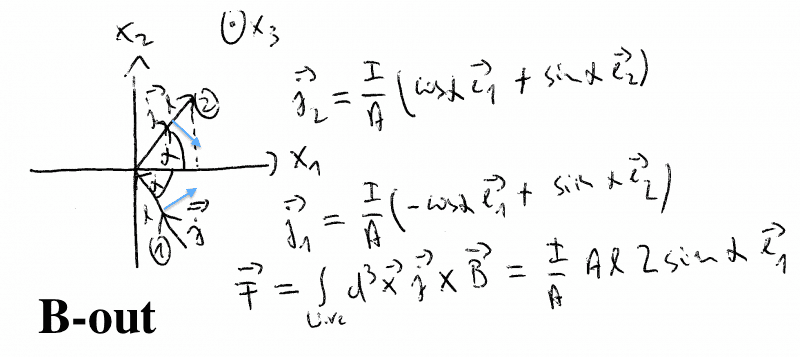

His little purple force arrows are in agreement with the vector convention i was taught,
colloquially: a dot is the head of an arrow, as if coming out of the page;
a cross is the tailfeathers of an arrow going into the page.
https://www.physicsforums.com/threads/current-a-vector-or-scalar.144239/
His horizontal blue force vectors are as you said, reversed if using my convention.
I never thought about current being a scalar, or if i did I've forgotten...
Is that because it's a dot product?

This figure looks right, but please never ever say the current is a vector as indicated by the red vector in the magnetic-force formula. This is highly misleading.
The current density is a vector, which can be defined in a fluid picture (a good concept for classical electromagnetics) of charges flowing around. Then you have a charge density ##\rho(t,\vec{x})##, which gives the charge per unit volume around ##\vec{x}## at time ##t##. Then the current density is ##\vec{j}(t,\vec{x})=\rho(t,\vec{x}) \vec{v}(t,\vec{x})##, where ##\vec{v}(t,\vec{x})## is the flow-velocity field of the charges.
The current is defined as the charge flowing through a surface per unit time. If ##A## is this surface and ##\mathrm{d}^2 \vec{f}## the surface-area vectors, whose magnitude gives the size of the infinitesimal surface element at the given point and its direction is perpendicular to the surface pointing in one of two possible directions. Which you choose is arbitrary. Then the current is the scalar
$$I(t)=\int_{A} \mathrm{d}^2 \vec{f} \cdot \vec{j}(t,\vec{x}).$$
If you change the direction of the surface-element vectors, i.e., the orientation of the surface, ##I## flips sign, but it has no direction.
Now in a certain sense, your formula is still correct. It applies to the typical case of a thin wire. At each instant of time, you can consider the current distribution as homogeneous across the wire's cross-sectional area. Then denoting with ##\vec{t}## the tangent-unit-vector field along the wire, the current density is
$$\vec{j}(t,\vec{x})=\frac{I(t)}{A} \vec{t}(t,\vec{x}).$$
Here, the orientation of the cross-sectional areas along the wire is given by the choice of the direction of the unit-tangent vectors, which are perpendicular to the cross section. Then the equations of motion (or Poynting's theorem) tells you that the force density due to a magnetic field is
$$\vec{f}(t,\vec{x})=\vec{j} \times \vec{B}.$$
To get the total force on the wire, you have to take the volume integral of this. Since the current only flows along the wire and since you can choose the volume elements as ##\mathrm{d}^3 \vec{x}=A \mathrm{d} ## you get
$$\vec{F}(t)=\int_{0}^L \mathrm{d} l A \vec{j} \times \vec{B}=I(t) \int_0^{L} \mathrm{d} l \vec{t} \times \vec{B}.$$
The latter you can write as a line integral along with the curve given by the wire with the (arbitrarily chosen!) orientation given by ##\vec{t}##:
$$\vec{F}(t)=\int_{\text{wire}} \mathrm{d} \vec{x} \times \vec{B}.$$
Now to the figure in #1. With the standard Cartesian coordinates and with the standard meaning of the dots as pointing out of the paper we have (for the straight wire) ##\vec{B}=B \vec{e}_3## (##B>0##), ##\mathrm{d} \vec{x}=\mathrm{d} x \vec{e}_2## and thus, for a homogeneous magnetic field
$$\vec{F}=I L B \vec{e}_2 \times \vec{e}_3=I L B \vec{e}_1.$$
So the force is pointing in the positive ##x_1## direction, i.e., to the right and not to the left as drawn in this picture.

My apologize for the incorrect direction of force. I didn't mean to have current seem to be a vector, just wanted to point out how I used the right-hand rule to figure out the direction of force(which was incorrect).
Could you please "dumb-down" you're conclusion to a beginner like me? I'm looking at the Math of F-1 and F-2 then the (net-F) and cannot understand as to why the Lorentz force of the straight wire and the zig-zag one are equal?
From the Math, I find them un-equal and for the zig-zag wire due to the orientation of the conductors and the flow of current it might be less? My apologize for not following along the Mathematic's provided, but I'm not yet capable of understanding & appreciating them yet.
What precisely is it what you don't understand? Perhaps Should I prepare a drawing with the geometry of the one zig-zag piece? It's really simple geometry, and the vectors should help with the calculation concerning the directions.
Well, as to how the non-linear wire(zig-zag) has the same Lorentz force as the linear one(Assuming all variables we're equal, but the orientation). What was intuitive to me is that they would differ?
Please, it might help me understand more.

Here it is
Thank you @vanhees71 I'm going to study this, and compare it to the straight wire.
I edited the image for the force vectors is this correct:
Where those blue arrows are the Lorentz force per part(upper/lower).
Yes. You have for the force densities
$$\vec{f}_1=\vec{j}_1 \times \vec{B}=\frac{I B}{A} (-\cos \alpha \vec{e}_1+\sin \alpha \vec{e}_2) \times \vec{e}_3=\frac{IB}{A} (+\cos \alpha \vec{e}_2+\sin \alpha \vec{e}_1,$$
$$\vec{f}_2=\vec{j}_2 \times \vec{B}=\frac{I B}{A} (+\cos \alpha \vec{e}_1+\sin \alpha \vec{e}_2) \times \vec{e}_3=\frac{IB}{A} (-\cos \alpha \vec{e}_2+\sin \alpha \vec{e}_1.$$
I've just used the right-handedness and orthonormality of the Cartesian basis, ##\vec{e}_1 \times \vec{e}_3=-\vec{e}_2## and ##\vec{e}_2 \times \vec{e}_3=+\vec{e}_1##.

Hmmm in post 13
might your very last formula
right side be: 2(script L) I / sin(alpha} ?
because
The zigzag wire must be longer to span the same vertical distance?
