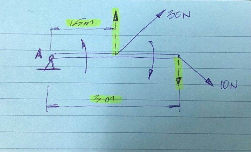

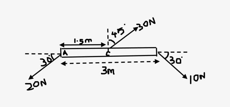

What is the net torque about an axis through point A?
Torque = F X d X sin theta
The net torque about an axis through point A is given by,
If I take the axis of rotation perpendicular to the paper and the solution I arrive would be the following below
Net torque = 30 cos45 x 1.5 - 10 cos30X 3
= 5.829Nm ( counterclockwise)
But the book gives an answer like this,
Net torque = 30 cos 45x1.5 - 10 x sin30 x 3 = 16.8Nm.What did I miss? It looks the horizontal component is perpendicular to the axis of rotation.

The figure does not show where point A is.
I have updated the figure. Are you able to see it?

But that is not quite the right test. The horizontal component here passes through the axis of rotation, so cannot have any moment about it.
To find the moment a force exerts about an axis, you can either find the perpendicular distance from the line of action of the force to the axis or find the component of the force which is perpendicular to the line joining the point of application to the axis.

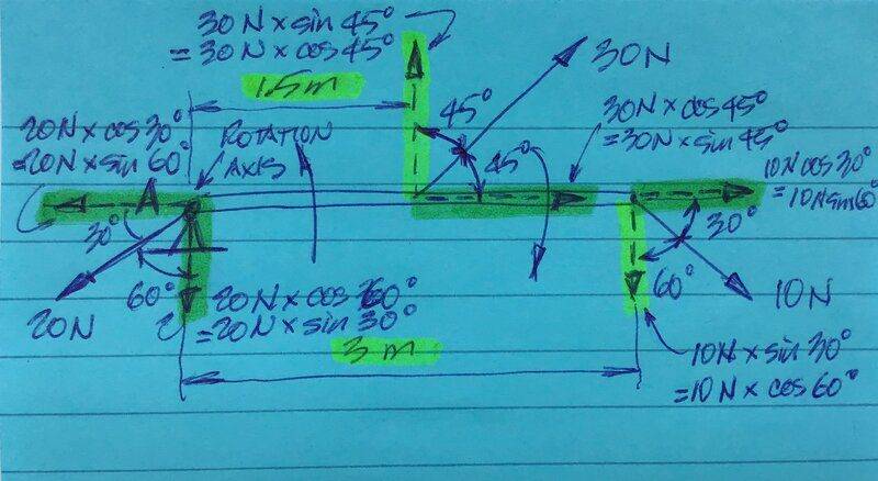

I think you are not grasping the error @paulimerci is making. It is true that the horizontal component of the 10N is perpendicular to the axis. Indeed, the whole of the 10N is because it lies in the plane perpendicular to the axis. As I wrote in post #6, that is the wrong test.
See https://www.physicsforums.com/insights/frequently-made-errors-mechanics-moments/
okay if the axis of rotation is along the horizontal component I take the perpendicular component sin theta for 10N. How about 30N force, it looks sin theta perpendicular to the axis of rotation and I cannot use cosine for 30N?
Of course, you are correct.
The confusion comes from the different orientation of the angles.
Cosine works for one, but not for the other.
That was the intended hint in my diagram.
Perhaps @paulimerci can graphically see the error in “10 cos30X 3”.
Perpendicular or not to the axis of rotation, a force that has no lever respect to a point is unable to induce any moment on it.

What are the correct calculated values of the vertical and horizontal components of the 10N force?
Which one is able of induce a moment respect to pivot A?

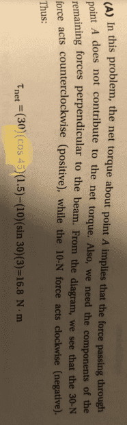

I got it right now, I was confused because the text book says cosine for 30 N force. That thing i still don't get it. As @haruspex said "To find the moment a force exerts about an axis, you can either find the perpendicular distance from the line of action of the force to the axis", I did that way and got the answer right.
Net torque at A = (30) (sin45)(1.5) - (10)(sin30)(3) = 16.8Nm
For the 30N force the angle is 45o. For that angle, cos and sin have the same value.

I understand that but for what reason cosine is used there? What if some other angle was given?
Look carefully at the diagram. The angle marked as 45° is the angle between the force and the "vertical", whereas the angle marked 30° is between the force and the "horizontal".

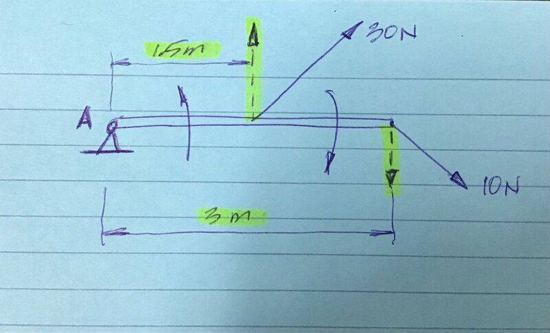

Is this how I have to choose the reference line? see the picture below

Call the two marked angles ##\alpha=45°## and ##\beta=30°##.
In each case, the line joining the point of application of force to the axis of rotation is horizontal in the diagram, so we want the component of force that's vertical. To find the component in a given direction we use the cosine of the angle between the two.
##\alpha## is the angle the force makes to the vertical, so we use ##\cos(\alpha)=\cos(45°)##.
##\beta## is the angle the force makes to the horizontal, so we use ##\cos(90°-\beta)=\sin(\beta)=\sin(30°)##
Sorry, I have no idea about what you are trying to represent in that picture.
The original question only refers to “the net torque about an axis through point A”.
There is no reference line to represent or discuss, I believe.
Sorry to ask, but how can you be still confused about this problem after studying the links provided in post #20 above?
  • #31
I’m not confused, I thought the reference line represents an arbitrary fixed line (as an x-axis or a polar axis) from which coordinates of a point are computed.
