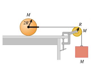

A uniform, solid cylinder with mass M and radius 2R rests on a horizontal tabletop. A string is attached by a yoke to a frictionless axle through the center of the cylinder so that the cylinder can rotate about the axle. The string runs over a disk-shaped pulley with mass M and radius R that is mounted on a frictionless axle through its center. A block of mass M is suspended from the free end of the string (the figure ). The string doesn't slip over the pulley surface, and the cylinder rolls without slipping on the tabletop.
Find the magnitude of the acceleration of the block after the system is released from rest.
Express your answer in terms of the variables M, R, and appropriate constants

Okay so I am fairly new to understanding torque. First I want to know if my equations are correct and if I am including everything. I'm having trouble moving on from here also. Any insight would be greatly appreciated.
elsternj said:
For the block:
[tex]\sum[/tex]F=ma
mg - T1 = ma
Looks good.

No. The tension T2 does not exert a torque about the cylinder's center of mass. What force does?
Ah, I see it doesn't exert a torque because it is actually attached to the point of rotation, right?
So... friction? -f(2R) = 1/2m(2R)2[tex]\alpha[/tex] ?

Exactly. (Get rid of that minus sign, though.)
