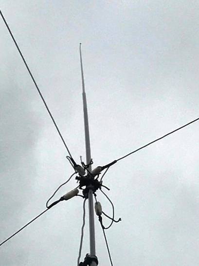

I was on a remote HAM assignment one time supporting a marathon run through the boonies, and set up a remote HAM radio station with a portable antenna and my vehicle. When I tried to contact Net Control, they kept replying that they could barely hear me, and there must be some problem with my radio. It was my standard portable setup, so I had no idea what the issue was until I connected my VSWR meter between my radio and my antenna. Ack, terrible VSWR! It was then that I noticed that I hadn't attached my counterpoise elements to the main antenna structure -- Duh. Screwing in the three counterpoise elements cleared everything up, and we were able to support the race like we were supposed to.
[/thread hijack]
https://4.bp.blogspot.com/-gohsJymy9CY/UEY1uPes7ZI/AAAAAAAAAIw/ZNpINIqrEKE/s1600/v20004.jpg
