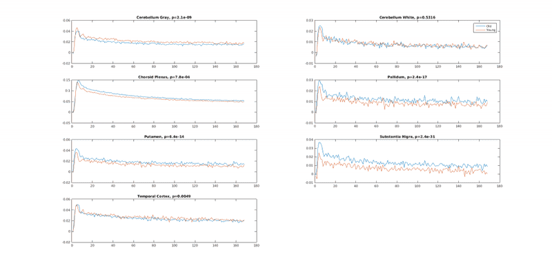

Inexperienced data analyst here with a real-world example,
I have attached a zip-file with screenshots and p-values of the following data. The "reference regions" are Cerebellum White, Cerebellum Gray, and Temporal Cortex. The top-most graphs depict the curves in the indicated region for young and old subjects. The bottom-most graph has two curves, one for the averaged old values, and one for the averaged young values.
Say I have MRI data for 11 different human subjects which allows me to see the concentration of some chemical compound in specific areas of the brain over time. I have a total of 180 time points for each subject. The data are noisy, but you can clearly see the peak immediately after injection, and the steady slow concentration decay for a time afterward.
I separate them into two groups, 5 younger and 6 older subjects.
Our hypothesis: We expect the older subjects' curves to decay more slowly than young subjects in some areas of the brain, but in the reference regions we would not expect much of a difference.
I use MATLAB to perform a two-sample t-test ('ttest2') on the average of the young subjects, against the average of the old subjects, and get P-values for each of the regions of the brain I am interested in.
What happens is that my p-values seem to somewhat reflect what I was expecting, i.e. the p-values for the reference regions are much higher than those of the other regions.
However, all of the p-values are very low to begin with (they are all statistically significant, P<0.05 ), which seems strange, and excluding a single subject from the analysis can drastically change the p-values by several orders of magnitude.
Why are my p-values so low? In the regions where I would expect a significant difference, the p-values are on the order of 10-17. This seems wayyy lower than I was expecting, the curves are not THAT different, right?
Is this because of the signal to noise ratio? Because I have a small number of subjects? Or because I have a large number of time points? Or some combination of these, or something else I may not have considered?
Any suggestions as to what I should do at this point?

So this is a pretty common misconception. A p-value is not a measure of how large a difference is. It is just a measure of how probable the data is if the difference were zero. If you collect a large enough sample, even the most miniscule differences can become enormously significant. So even in the reference regions it is unlikely that the true difference is zero.
With that said, your statistical test sounds like it might be suboptimal. The data almost surely are not normally distributed. What might be normally distributed would be the residuals to some curve fit. It seems that it would be more reasonable to fit the time courses to some appropriate signal model and then do your statistics on the fit parameters. Also, since you have different N for your Two groups I would tend to use an ANOVA or a linear model rather than a T test.

But are you interested whether the two curves are the same? They're clearly not for most of the data you linked. In a lot of cases I see one curves always lying below the other curve with a significant distance. This is not what I would expect for two curves that are supposed to be the same.
But in your OP your question is not "the two curves are the same" but rather "the rate with which the curves decrease is the same". This is a very different question!
Attached a condensed version of the original attachment.

I only gleaned that information from the MATLAB help file on the t-test. I am kind of scrambling to learn this stuff.
micromass said:
In a lot of cases I see one curve always lying below the other curve with a significant distance.
This is what we are expecting. One group would be different than the other group, that is, the older group should have a roughly higher concentration than the younger group for all or most time points. I can see the difference with my eyeballs in some regions, but it is not clear from the statistical test. This is why I am looking for help. (That, and I have no prior experience with statistics)
Condensed version of the data attached to this post, in .png format.

While that is true, that doesn't help the OP understand why he is getting the results he has found. He has some data which "are not THAT different" and is surprised by how small the p values are. He knows that the p value should lead him to reject the null hypothesis, but is surprised by that because he has the common idea that we reject the p value when the difference is large.
Instead, we reject the p value when the observed difference is unlikely. We can make an arbitrarily small difference unlikely (and therefore statistically significant) simply by including an arbitrarily large sample. So a low p value does not indicate a large effect, as expected by many people.

since you are already using Matlab there are nonlinear fitting routines already available. You would want to start with those.
Since you are interested in the rate of decay, your chosen fit function should have a parameter which adjusts the "height" and a parameter which adjusts the decay rate. From your plots it seems likely that all of the heights will be significantly different, but maybe not the decay rates.

If I understood correctly: For each subject you have a time series (180 points). You then average the time series across subjects within each group.
Could you please clarify, what exactly did you feed into the ttest2 function? The entire average time series of 180 point each?

Yep, I averaged across subjects within the groups, resulting in two curves of 180 time points each. One for the old subjects, and one for the young subjects. I compared these two curves using ttest2.
We have since hired a statistician, and she has done some modeling, some statistical analysis that probably makes more sense... I am hoping that she will not mind teaching me the process so I can recreate it on my own.
