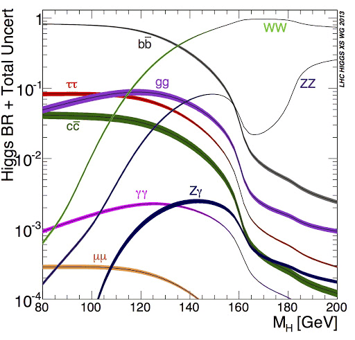

Another Higgs mass property
The Higgs boson mass is very close to the mass which maximizes the branching fraction of the diphoton decay channel. This could have a deeper meaning rather than being a coincidence.
Entropy In Higgs Boson Mass Decays
The entropy of the Higgs boson decay probabilities distribution in the Standard Model (SM) is maximized for a Higgs mass value that is less than one standard deviation away from the current experimental measurement. (Source). There is a theoretical argument that this too is not just a coincidence.
