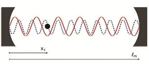

It would appear that the sensors employ optically-trapped microspheres or microdiscs, the positions of which can be measured to microns or better as these images from Northwestern suggest:
246747
Fig. 1 - High frequency gravitational wave detection with levitated sensors
246748
Fig. 2 - Testing gravity at micron distances with optically trapped microspheres Just found this paper on arxiv by Geraci and Arvanitaki from 2013, which lays the groundwork for the proposed detector: Detecting high-frequency gravitational waves with optically-levitated sensors . The paper suggests that the detector would have
...improved sensitivity in the frequency range of 50−300 kHz that does not rely on a shot-noise limited displacement measurement of test mass mirrors, but rather depends on a precision force measurement on the resonant harmonically trapped sensor.
If somebody knows more about this project, I'm sure the folks here at PF would like to know more.
