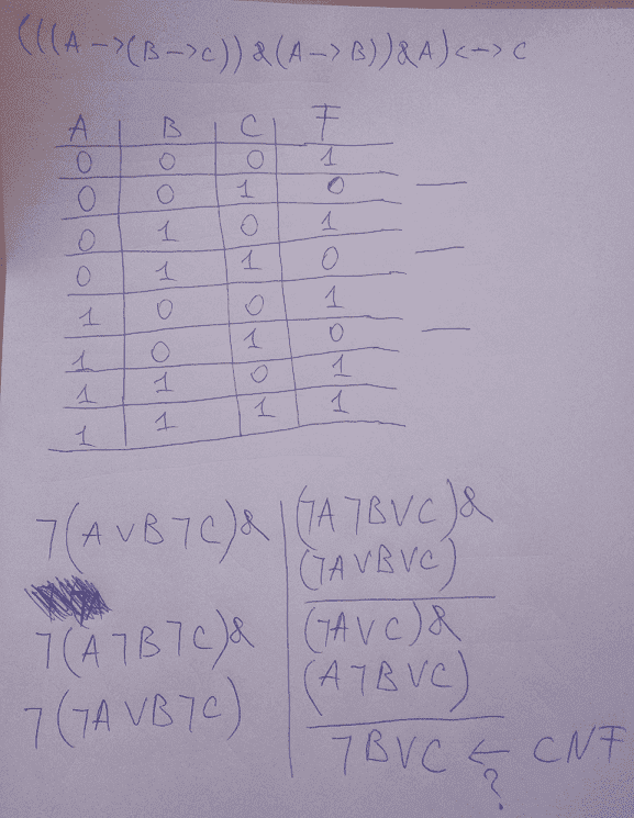

Hello I'm new here. Can someone please help me with the conjunctive normal form for this formula ?
(((A -> (B -> C)) & (A -> B)) & A) <-> C
I don't know if i did this right or not. If not what should i do ?

Hi ion88, welcome to MHB! (Wave)
No worries.
I believe you've already correctly filled in the table, which is what MarkFL uploaded for you.
I'm afraid it also means that the conjunctive normal form that you had found (¬B ∨ C), is not correct.
We can verify by checking (¬B ∨ C) against your truth table, and see that it does not match. (Worried)
The easiest way to convert your truth table to conjunctive form, is through a so called Karnaugh Map.
It looks like this:
\begin{tikzpicture}
%preamble \usepackage{karnaugh-map}
\node {
\begin{karnaugh-map}[4][2][1][AB][C]
\minterms{0,1,2,3,7}
\maxterms{4,5,6}
\implicant{0}{2}
\implicant{3}{7}
\end{karnaugh-map}
\end{tikzpicture}
From this Karnaugh Map, we can deduce that the corresponding disjunctive expression is:
(A & B) ∨ ¬C​
That is, the green rectangle corresponds to (A & B), and the red rectangle corresponds to ¬C.
The resulting expression is true if we are in the green rectangle OR in the red rectangle.
We can convert it to conjunctive normal form by using the distributivity of boolean expressions:
(A & B) ∨ ¬C = (A ∨ ¬C) & (B ∨ ¬C)​
(Thinking)
