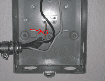

Forgot to mention disconnect is non fusable 60 amp. Breaker outside is 40 amp breaker. As I want the exterior breaker to trip without burning the 60 amp non fusable pullout disconnect

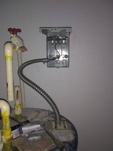

Line view ( non load )

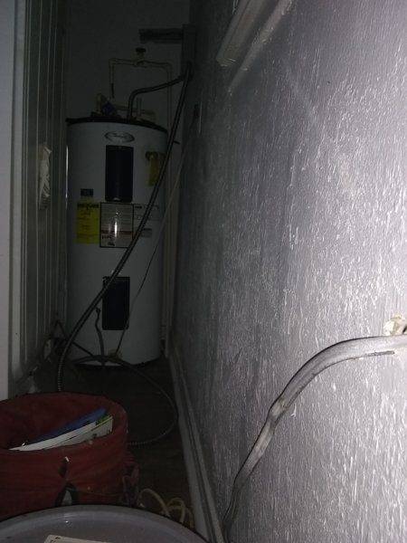

Anticipated 8 foot span of dry use conduit 26 inches from floor level supported with clamps every 3 feet.

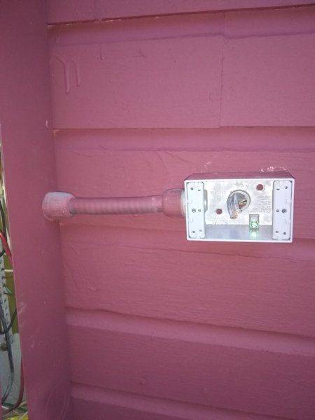

Exterior side ... I'll pigtail and place cover obviously just wanted you all to see what I am dealing with.

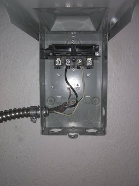

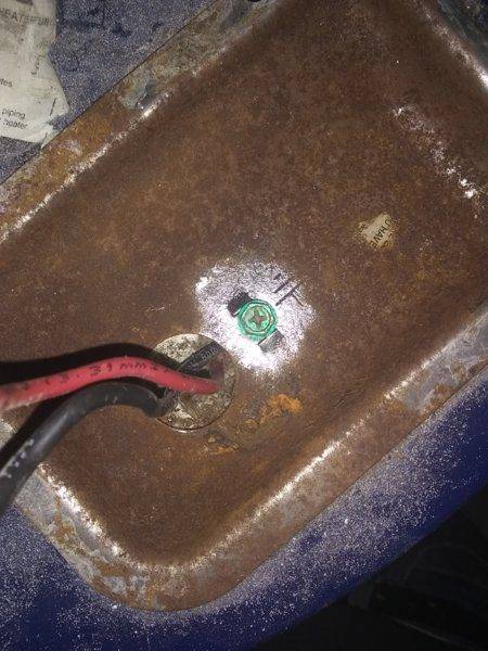

Hot water heater ground I cleaned it to allow a solid non corroded ground.

What i see looks well done, just needs the disconnect covered and conduit supported..
8 feet you say ? NEC limits flex conduit length to 6 feet unless you put a grounding conductor in it
Picture looks like there's one already. If not, pull a green one same size as other two.

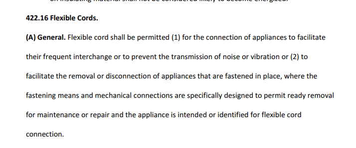

There's this interesting paragraph in NEC
suggesting a 50amp range outlet and cord might be viable .
Look carefully in the water heater instruction pamphlet for mention of connecting with a flexible cord. That would make it "identified" .
The receptacle can be your disconnect so long as it's accessible.
Adding isolation valves and unions would satisfy the "mechanical connections" clause, and simplify replacing elements.

The water heater was here before I inherited the property.. they simply ran exposed wires through the kitchen a true DIY.
Can you elaborate on the need for a ground on over a 6 foot run that is what my confusion is... Are my pictures to forum standards? I'm going to assume so an try to show you the ground situation

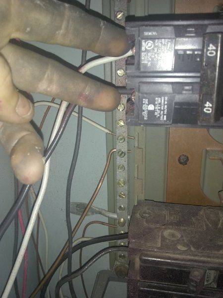

The two fingers identify the breaker, below there is the all wire ground. That will run direct from this BREAKER through conduit through disconnect to hot water heater ground screw.
The picture you listed is what I read but it confused me if this complied with ground requirements.
Conduit will be supported with approved brackets 3 on the 8 foot run and one within 12 inches of every end that meets a box if that makes sense.

Oops! I see you have Liqui-Tite flexible conduit there. That may or may not be acceptable (probably not) for that usage, you may have to use solid conduit and the appropriate fittings.
General rule is that any couplings in an area exposed to liquid must be oriented so that liquid will flow away from the coupling.
If you continue to use flexible conduit for this part of the installation, the conduit on the left needs a 90° elbow facing downwards and the conduit entry to the box must be on the bottom. You also need to replace the box as it is not liquid tight due to the mounting holes on its back wall. Boxes for wet areas generally have their mounting holes on ears so there is no penetration for liquid to sneak in.

Thanks Tom! It's confusing! Makes perfect sense what your saying! The box and fittings said "suitable for wet locations" they had rubber washers with a compression fitting on both union ends.
I understand that's not applicable in all situations EG underwater..
So if I understand correctly the union on the left must 90 downwards... Followed by a rigid metallic 90 to the roght and into the bottom of the box... This shape in lament term...

and this looks to me like a ground wire is there already
yes i think you're headed the right direction.

Or it might be easier to put another hole in the wall and move the box higher. Bending conduit is a bit of an art, avoid if you can! Use fittings instead.
You MAY get away with using the flex outdoors, that would make things a lot easier. Suggest you find out if it's allowed. Also visit your local chain home improvement hardware store. Browse their electrical hardware and ask questions, every once in a while you run across an employee that is actually knowledgeable! If not, try again on a different shift.

That is a ground wire.
