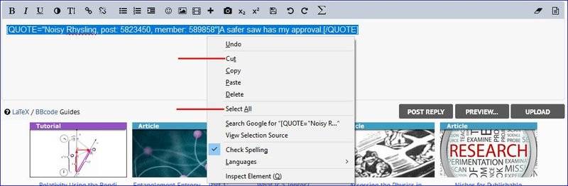

jack action said:
I guess if the thread is spread on multiple pages...
You might be able to just make a reply in the text box of the original page, then select the text, or click select all... then "cut" and paste the text into the reply box on a different numbered page... ?
The below text actually came from another thread...
Noisy Rhysling said:
A safer saw has my approval.
Here's a screen shot of what I'm trying to say...
Clear as mud, eh ? :oldsmile:
