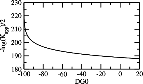

Hello, I am new in the field of FORTRAN. I started to write a code using Newton Raphson method. Below is the code of main program portion only. During my calculation, I have found that my results are not converging, Any help or advice will be highly appreciated in this case.
Thank you for the effort of helping in advance. Program Free_energy

I find that graphing the results of the iterations can be helpful.
Up the number of iterations and check for their convergence...it seems to me at first glance that you are not iterating enough.
First I would like to thank you both for the reply,
Since you have mentioned that increasing the iteration number may solve the problem, but my question is how can I do that?
Also in my code, the function has summation over an exponential series of the Gimc, I am afraid of that also because I think that summation is also not happening there properly.
Further, I made two changes in the expression of the derivative of my function (Cagg2) and the expression of Keff in my code. The rest of the code is unchangeable and almost like the previous one except that two lines. I ran this one and I find this plot (-log(Kapp)/2 vs DG0) attached with this reply. My aim was to calculate the "cf" which has also the negative values in the calculated results.
I would like to thank you again for the help. Any advice or direction in this case will become helpful to me in near future.

part of your issue is that for example you define Nwat as a double, then assign an integer to it, yes it theoretically works, but better programming style is
Nwat = double(j)
it makes a double out of the j so that it is j.00000000
Thank you for the reply, I will follow your suggestion and let you know about the result.
