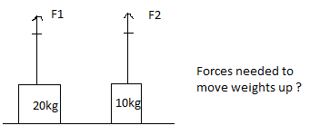

Decompose the problem, then try to add complexity one by one.
Initial decomposition reveals the problem given as attachment.
How current problem differs from attachment ?
For pulley, taking upward as ##+Y\uparrow##
##F \hat j + T(-\hat j) + T(-\hat j) = m_{pulley} . \vec{a_{pulley}} = 0.\vec{a_{pulley}}##
##~~\Rightarrow~~ T = \frac{F}{2}##
Now, draw FBD of each masses separately, and find the magnitude and direction of accelerations.
Sign of acceleration is important.
