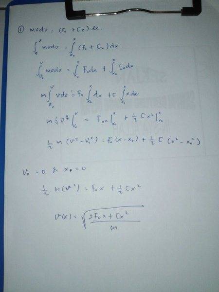

Fia Ismi Nur Alfiah
Find the velocity ± and the position x as functions of the time t for a particle of mass m, which starts from rest at x =0 and t =0, subject to the following force functions:
(a) Fx = F0 + Ct
(b) Fx = F0 sin Ct Ct
(c) Fx = F0e^ct
where F0 and c are positive constants.

You cannot integrate t with respect to x until you know what t is as a function of x.
I am not sure why you want to integrate wrt x anyway. What else can you do?
By the way, your typed notation is a bit confusing. You mean Fx=F0+Ct. I.e. F subscript x, not F times x.

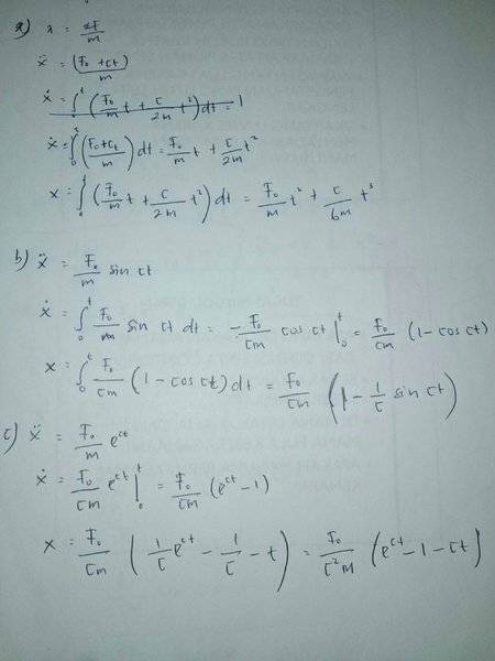

I have checked my homework, how about my answer here?
You made a mistake in the final step in both a and b.
(In post #1 for part b you specified the force as F0sin Ct Ct. i assume the second Ct was a typo.)
