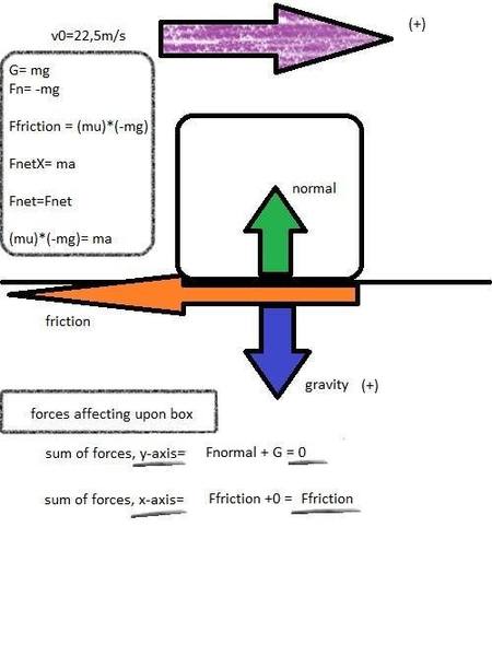

So you need a relevant equation that has to do with this given. Let me help you:$$F_{\rm friction,\ max} = f\;N$$ where N is the normal force. (notice a difference with your sentence ?)
Draw the ... FBD ! o0)
Since the exercise asks for the shortest distance, you may assume this friction force is indeed at maximum value for the calculation you are going to do.

Here you should be careful: just look at the forces on the box.
There is only one: and it has to act in the direction of the acceleration.
I still think that the accelerations of the box, and acceleration of the car, must be equal value. If this is not so, then I think the box would move, with respect to the truck's floor. The goal of the problem was that the box should stay still with respect to the truck's floor.
This is correct - friction opposes the relative velocity between the contact surfaces.
The thing is, you don't need to know this to do the problem: you only need to know the relationship between force and acceleration.

Have you drawn a free body diagram for the box yet?
I was discussing the problem witha good friend of mine today.
Im not sure that I completely understood the relevance conceptually regarding static friction force
I guess that the box must be decelerated at some force. It's impossible to stop the box, without applying a net force in the opposite direction of the initial velocity. If the net force of the box were zero, then the box would keep on moving forward.
Box and the truck were traveling at the same constant velocity originally. Box must stop at v1= 0 If the accelerations had been differerent between each other... then the box would have slided across the floor.
I'm not sure that I completely got the FBD correct but here's a picture at least... I am not sure what I'm supposed to see.
I suppose the forces that act on that particular body, are those forces that are summed up, to form the net force for that body.
Your second diagram should be just the truck by itself: a fbd has only one mass in it.
The next step is to write ##\sum F = ma## for each diagram... also see post #8
The friction force appears in your free body diagrams as one of the forces acting on the box (and also the truck). That is all there is to it.
Where does the left side of the equation come from algebraically speaking?
All the equations come from your first free body diagram and Newton's second law of motion.
This is what I had come up with But I don't know if that's the proper way to do it.
