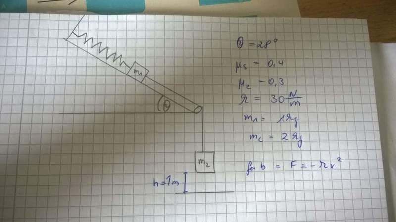

Dear Helpers,
I'm sitting since ours in front of a task and trying to solve it.
Attached you find a picture to the problem.
Given:
θ=28°
μs=0.4
μk=0.3
k=30N/m
m1=1kg
m2=2kg
x0=0
x1=1m --> Spring is stretched
The question is:
Does m2 move up or downwards?
First thing I tried to solve it like this: I considered gravitation, friction and the force of the spring.
So I was thinking the following:
F(Spring)=-k*x
F(Object2)=m2*g
F(Object1)=m1*g*sin(28) <-- is this sin(28) correct?
F(Friction)=μk*F(Normal)
What is in this case the normal Force (F(Normal))?
F(Spring) + F(Friction) > F(Object2) + F(Object1) --> moves upwards
F(Spring) + F(Friction) < F(Object2) + F(Object1) --> moves downwards
I do understand, that I need to sum up all the forces an compare them. But is my way correct? Do I forget to consider sth? Maybe somebody is able to help me.
b) Would be "When does m2 touch the table gently?
For task b)
F=-kx^2
h=1m
Thanks in advance
Gio
Yes that is correct
It isn't the kinetic friction you need to consider, it's the static friction.
It is the component of m1*g that is perpendicular to the slope. Do you know how to calculate this?
You are close.
If the absolute value of F(Object2) + F(Object1) - F(Spring) > F(Friction) then m2 (and the whole system) moves.
If, on the other hand, [itex]|F_{obj1}+F_{obj2}-F_{spring}|<F_{static.friction}[/itex] then the system doesn't move.Whether or not it moves depends on the absolute value of the forces.
Which way it moves is determined by whether the net force (you don't have to include friction) is positive or negative.
So when figuring out which way it moves, you don't need involve the force of friction (AS LONG AS you've already determined that it DOES in fact move).(This is why I asked you to find out what had to be true for the system to move.)
