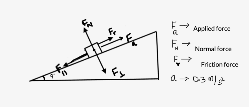

A 65 kg cyclist on a 10 kg bicycle is moving uphill on a 9° slope. How much force does he provide
if the bicycle slows at a rate of 0.3 m/s2?
Net force = ma
F parallel - F applied - rolling resistance = ma
I don't know how to calculate for rolling resistance. If the bicycle is not slipping rather it is rolling, should I ignore rolling resistance? And if I ignore that I would get,
F parallel - F applied = ma
F applied = F parallel -ma
= mg sin theta -ma
= 75x0.3 - 75 x 9.8 x sin9
= 92.5N
And the answer I got is not correct. Looks like mass is taken as 65kg and not as combined mass 75kg and I don't know why?

The question is badly posed. What does ”force he provides” mean?
However, the interpretation that gives the sought answer is what the net force of the bicyclist on the bike is.
Likes bhobba and paulimerci
It's 65, not 75. And you have reversed the sign; in the preceding line you had mg sin theta -ma
Likes paulimerci
Thank you, why 65 is used rather than 75?
oh okay, Now I got it. Thank you!

It may not be worth your while spending too much time worrying about this problem. The issue isn't rolling friction. We can assume that resisting forces (other than gravity) are negligible here.
After some thought, I think that the problem is not just badly phrased but wrong. There's no doubt about the net force on the cyclist. But, that's not necessarily related to any active force that the cyclist provides. Here's my analysis.
Let's consider a modern bicycle where the rider is seated and manifestly pushes forward on the pedals with force ##F_1##. There is then an equal and opposite reaction force from the pedals.
There is also a force from the seat of the bicycle forward on the rider (##F_2##) and an equal and opposite reaction from the rider's back. The unbalanced force is ##F_2 - F_1## and this is what accelerates the rider and what has been calculated here. Whereas, by no stretch of the imagination is that the force that the rider provides. The rider provides the force ##F_1##. And, clearly, this force depends on the gearing mechanism of the bicycle. And, if you ride a mountain bike, you see how much that force (##F_1##) can vary across the gears.
You might argue that the rider is ultimately responsible for the net force ##F_2 - F_1##, but there is also a third force (##F_3##) from the ground to the bicycle. And, ultimately, the rider is responsible for that force as well.
You might also argue that ##F_2 - F_1## is the net force provided by the rider to the bicycle. And that "provides" includes passive, reaction forces. But, then, the same argument would apply to a motorist being accelerated by a car seat. There is an equal and opposite force provided by the motorist's back on the car. So, you would have to say that the motorist is "providing" the force in that case too.
Likes paulimerci and jbriggs444

Force bicycle exerts on cyclist ##= m(\vec a-\vec g)##.
Force cyclist exerts on bicycle ##= m(\vec g-\vec a)##.
The flaw in the question is that to get the given answer it should ask for the component parallel to the plane.
Orodruin said:
But the problem in essence asks about the force on the rider — not rider+bike.
But the bicyclist can’t push the pedal downwards and the bike uphill without having the bike pushing his mass along, so he stays on the pedal during the slowdown process.
Want it or not, his energy or work is accelerating the mass of the bike and his own mass simultaneously, while gravity is doing the opposite work, ...and winning.
