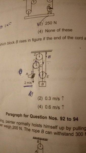

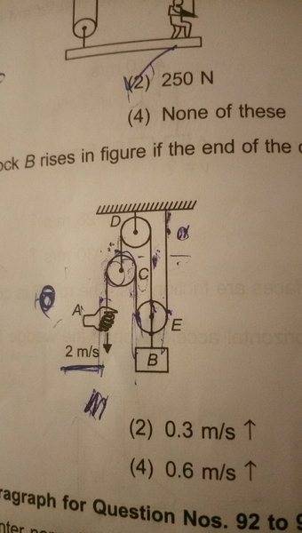

Determine the speed with which block B rises in figures if the end of cord at A is pulled down with a speed of 2ms^-1
Given Velocity downwards at A=2m/s
Really stuck... Couldn't even start the question solving...I know all policies and therefore i am not demanding the question to be solved but just a hint on how to start will surely help

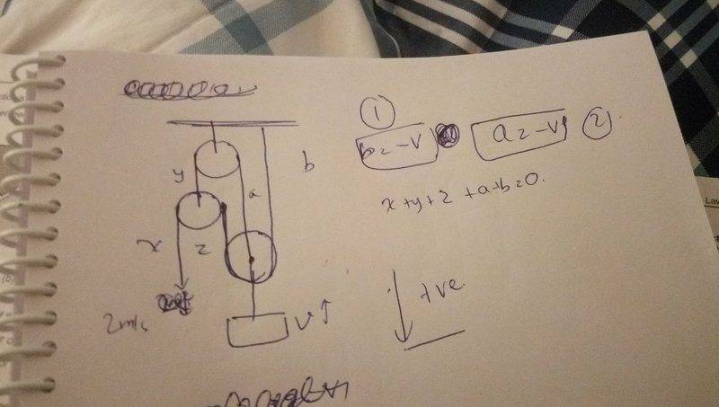

Yea i started again but ended with nothing..I can show u my work if u want
This is what i did...i m stuck after this!
I don't know if it is allowed, but I used distances instead of velocities.
Just took a starting position, moved the block B 1 unit distance and calculated the distance each other bit moved if the string stayed tight.
That gave me a velocity ratio.
If mass B moves up ##\delta##, how much does the pulley that supports A move down?
Is it 3##\delta##
Vv anand said:
Is it 3##\delta##
No. Look at the diagram carefully.
Oh is it 4 ##/delta##
Just because of the middle string attached to the mass coming from the upper left pulley
No. Look carefully. The wire between pulley
I get that the pulley supporting A moves down ##\delta## if mass B moves up ##\delta##. This focuses on the wire that passes over pulley D.

The set-up is sufficiently complicated that it is best to take a very disciplined approach.
There are four distances of interest: AC, CE, CD, DE.
We need four equations to relate them. Some equations will be that one distance is the sum of others, while others will be that a sum of distances is constant.
@Vv anand , what equation relates:
AC, CE, DE?
CD and DE?
AD, AC and CD?
CD, CE and DE?

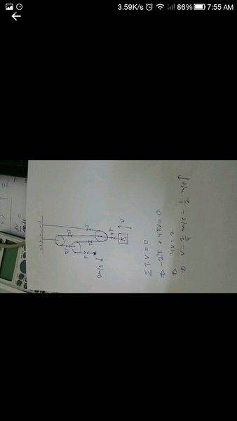

Like this?
Vv anand said:
Like this?
Yes, that works.
