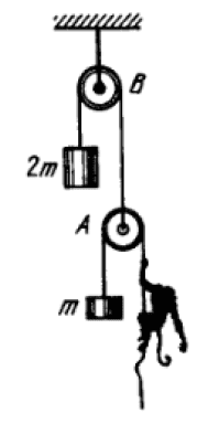

A monkey which has a mass of ##m## is hanging on a rope as the picture shows. Then the monkey starts to move upwards with speed ##u##. Find how the box which has a mass of ##2m## will move. Neglect friction between the rope and pulleys. Assume that pulleys are massless.
Newton's laws.
I don't understand why ##2m## has to move in the first place. The motion of the monkey affects only the box with mass ##m##. The downward net force in pulley A remains the same. The monkey is even hanging on entirely separate rope. I don't see how ##2m## can be affected. Please help!

Are you sure the upward motion of the monkey is only relative to the second pulley? The problem says it moves upward with speed u, but it doesn't say anything about what combination of motions of the pulleys is used to achieve this upward velocity.
I would say the only reasonable assumption is that u is relative to the rope the monkey is on. I guess we also have to assume that the monkey has mass m.
The mass m moves up at the same speed as the monkey. That's one of the Lewis Carroll problems..

So, as the center of inertia of the monkey and mass m move up, what happens to the center of inertia of the monkey, mass m, and mass 2m?
The mass ##m## will move with the same upward speed as the monkey, so I suppose their center of mass will move upwards with the same speed they are moving. Then, ##2m## should move upwards with speed ##u## in order to maintain the same distance between ##2m## and A.
The mass m will move with the same upward speed because both moves with the same force so the same acceleration and initial conditions are the same.

You are asked about the movement of the 2m box. You show that relative to the ground it will be the same upward speed as the monkey's, but that is not the same as the monkey's speed relative to the rope. How will those last two speeds be related?
For the same time Δt if monkey take l rope moves up l/2 so the relation between two speeds is 1:2.

No, the problem is subtler than that. For the monkey to move at all, it must slightly increase the rope tension. The 1m mass will experience the same increased rope tension and so accelerate in exactly the same way as the monkey. Similarly on slowing down. Thus the monkey and the 1m mass are always at the same vertical speed.
Now apply that argument to the monkey+1m mass as a combination, against the 2m mass.
But I agree with your conclusion in the land frame. Not sure about the rope frame yet.
Right. Even acceleration is non constant, the 2m and the monkey moves both with the same acceleration every time. With the same initial conditions (i.e. v(t=0)=0) they have the same speed every time.

The monkey starts off stationary and accelerates to velocity u. During that acceleration phase the mass m also accelerates to velocity u.
During the acceleration (a) there is a excess force on their pulley = 2ma
That force/tension acts on the mass 2m. So mass 2m accelerates upwards at 2ma/2m = a.
Once the monkey reaches velocity u it stops accelerating so mass 2m stops moving.
The problem doesn't ask us what happens when the monkey decelerates but mass 2m will descend again.

We all agree that the monkey and the two masses all rise at the same speed relative to any given reference. But it would be strange if the question were asking for the speed of the 2m mass relative to the bit of rope the monkey is holding. So knowing now that the speed u is relative to the rope, the speed of the 2m mass (relative to the ground, I suggest) is something else.
As you noted in post #14, the monkey and the 1m mass each rise at rate u/2 relative to the lower pulley. We can then apply the same logic to find how the 2m mass moves.

If u is the monkey's velocity with respect to the rope, (and OP has confirmed that this detail was omitted from the original problem statement) then I agree with this result.
Of course, we can also arrive at this by considering the analysis in Post#15:
Let's say the monkey's velocity is ##v## in the inertial reference frame in which all the the objects are initially at rest.
Then the monkey, the 1m mass and the 2m mass all have velocity, ##\ v\,,\ ## upward.
Pulley A, will then have velocity, ##\ -v\,,\ ##, i.e. Pulley A moves downward at speed, ##\ v\ .##
The 1m mass is moving upward with velocity, ##\ v\,,\ ## so that the length of rope on the right side of Pulley A is increasing at rate ##\ 2v\ .## Combine that with the fact that Pulley A moves downward at ##\ v\ ## gives the rope the monkey holds onto is moving at speed ##\ 3v\ ## downward, So the monkey's velocity w.r.t the rope is ##\ 4v\ ## upward.
I.E. ##\ 4v=u\ .##
