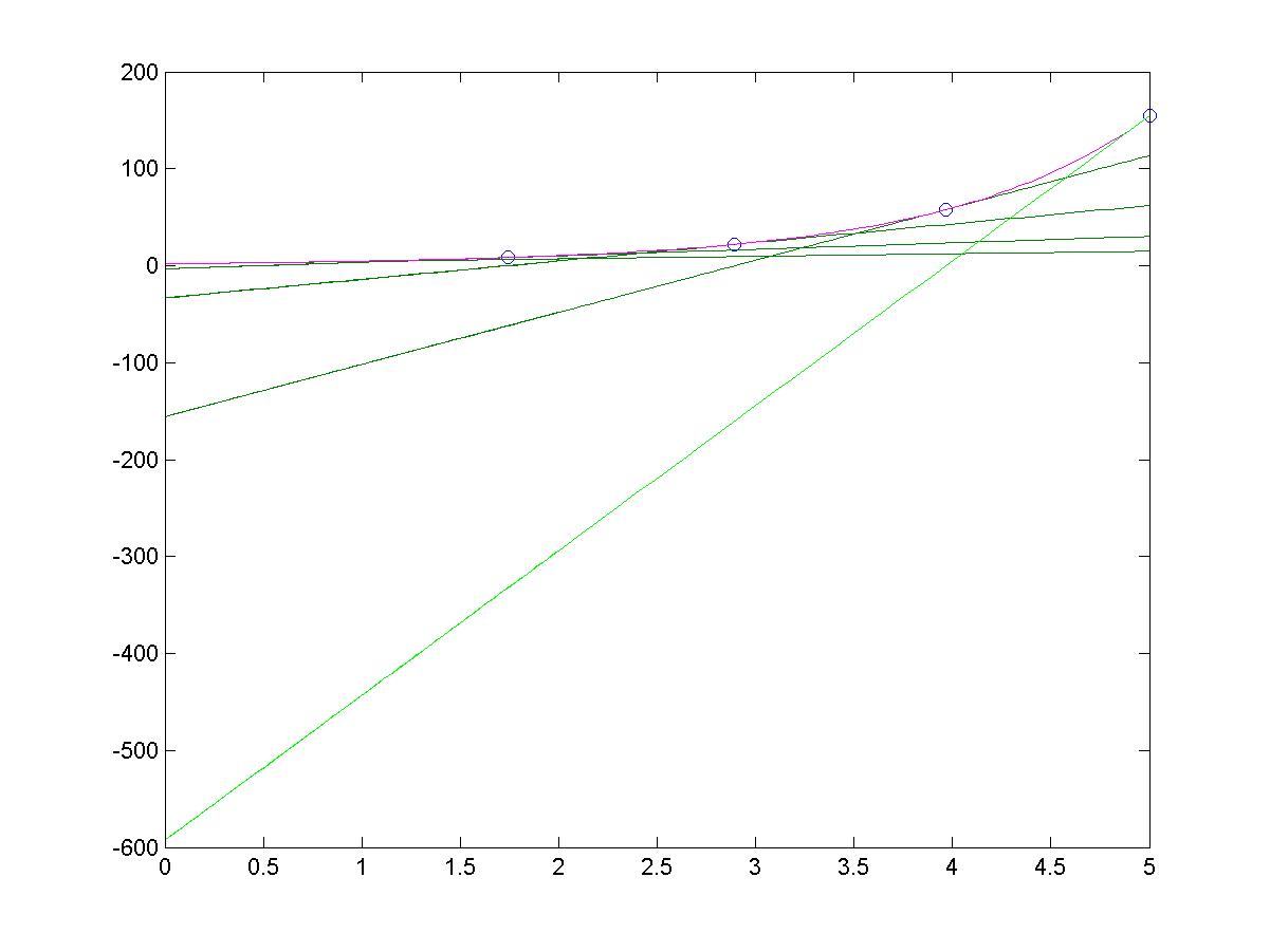

Re: Newton method-numerical analysis
At my graph, except form the five first approximation there should also be the function f and its tangent.. My code is the following:
Code:
tan=@(x) g(x_o)*(x-x_o)+f(x_o);
plot(x,f(x),'m',x,tan(x),'g')
 hold on
for k=1:5
    if (g(x_o)==0)
        return;
    end
    x_1=x_o-f(x_o)/g(x_o);
    t=@(x) g(x_1)*(x-x_1)+f(x_1);
    plot(x_o,f(x_o),x,t(x))
   hold on
    x_o=x_1;
end
The plot that comes out is this: (see attachment).
Is this right?
How can I show how the algorithm works as you said in your last post??because when I do it like that
Code:
 plot(x(k),f(x(k)),x(k+1),0);
    hold on
it says that there is somewhere an error...
:confused::(
Code:
 hold on
for k=1:5
    if (g(x_o)==0)
        return;
    end
   hold on
    x_o=x_1;
end
Is this right? :confused::(
Perhaps you can replace
Code:
by
Code:
    t=@(x) g(x_o)*(x-x_o)+f(x_o);
    plot(x_o,f(x_o),x_1,t(x_1))
Code:
    hold on
Not entirely sure since I don't have Matlab.
But perhaps it's trying to access x(6) even though it does not exist?
What error does it give?
