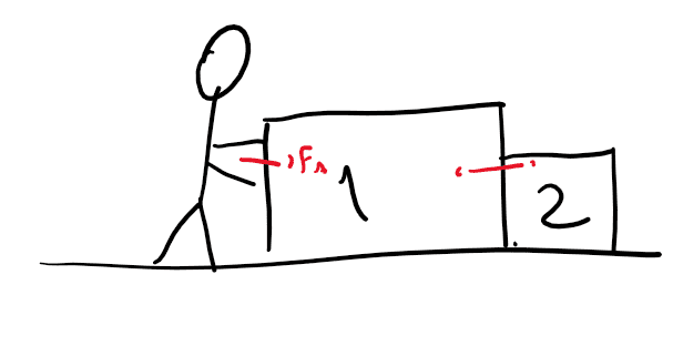

I understand that every action force has a reaction force of equal magnitude and opposite direction. In the drawing below, I undertsand that box 1 exerts a force on box 2, and box 2 exerts a force of the same magnitude but opposite direction on box 1 (it is an internal force). That being said, let's say that the person pushing on the two boxes pushes with a force of 25N, and the boxes expericne 10N of friction - what are the opposite and equal reaction forces to the forces listed above (what force is opposite and equal to the 25N of the applied force, and what force is opposite and equal to the 10N of friction force?).

The net force is non zero on the system I.e. the boxes are accelerating. I don’t think you can tell without the masses of the boxes, and friction force acting in each.

The problem looks pretty straightforwards (except maybe if you wanted numerical values for the BoxA<>BoxB force interaction, the value for friction [and mass] needs be specified for each box).
But, regardless of acceleration, the forces are still balanced when all the players are accounted for ; not just the person and the boxes.

Regradless of whether the person and the boxes are accelerating or not, if the person exerts 25 N on box 1 to the right, Box 1 exerts on the person 25 N to the left. If the ground exerts 10 N to the left on the boxes, the boxes exert 10 N on the ground to the right.
If the system starts moving from rest, how does it accelerate? Note that friction between the feet of the person and the ground provides the accelerating force to the right and must be greater than 10 N. If it's equal to 10 N, the system will be moving at constant velocity.

That can be done. If the coefficient of kinetic friction between ground and boxes is ##\mu_k##, and the force exerted by the person is ##F_0##, we can write the Second Law fro the two-block system and find the common acceleration first. $$F_{net}=F_0-\mu_k(m_1+m_2)g=(m_1+m_2)a\implies a=\frac{F_0}{m_1+m_2}-\mu_k g.$$The net force on leading block 1 is $$F_{net}=m_1a=m_1\left(\frac{F_0}{m_1+m_2}-\mu_k g\right)=F_{21}-\mu_k m_1g \implies F_{21}=\frac{m_1}{m_1+m_2}F_0.$$The net force on trailing block 2 is $$F_{net}=m_2a=m_2\left(\frac{F_0}{m_1+m_2}-\mu_k g\right)=F_0-F_{12}-\mu_k m_2g \implies F_{12}=\frac{m_1}{m_1+m_2}F_0.$$ Note that the forces between the boxes are independent of the coefficient of kinetic friction. They have the same value even when the boxes slide on a frictionless surface.

I mean the same for any CoF. As you see from the derivation in post #10, $$F_{21}=F_{12}=\frac{m_1}{m_1+m_2}F_0.$$ The CoF, whatever its value, affects only the acceleration not the Third Law pairs.

Seems like you might have labled your blocks opposite of the diagram in the OP?
Interesting though, I didn’t see that they would only depend on mass and pushing force, not friction (I didn’t solve it).
Good catch. Thanks.

By my reckoning there are five pairs of third law forces in that scenario. Can you label them?
