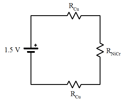

In summary, the circuit consists of a 1.5 V battery connected to a Nichrome wire by two copper wires. The copper wires have a radius of 0.009m and are 0.17m long, while the Nichrome wire is 0.08m long with a radius of 0.003m. The copper wires have 8.4 x 10^28 mobile electrons per cubic meter and an electron mobility of 4.4 x 10^-3 (m/s)/(V/m), while the Nichrome wire has 9.0 x 10^28 mobile electrons per cubic meter and an electron mobility of 7.0 x 10^-5 (m/s)/(V/m). The
Callix
106
In the circuit shown, two thick copper wires connect a 1.5 V battery to a Nichrome wire. Each copper wire has radius R = 0.009m and is L = 0.17m long. Copper has [itex]8.4 \times 10^{28}[/itex] mobile electrons/[itex]m^3[/itex] and an electron mobility of [itex]4.4 \times 10^{-3}[/itex](m/s)/(V/m). The Nichrome wire is L2=0.08m long and has radius R2 = 0.003m. Nichrome has [itex]9.0 \times 10^{28}[/itex] mobile electrons/[itex]m^3[/itex] and an electron mobility of [itex]7.0 \times 10^{-5}[/itex] (m/s)/(V/m).
a). What is the magnitude of the electric field in the thick copper wire?
b). What is the magnitude of the electric field in the thin Nichrome wire?
14e008af-1ee3-40de-a0f2-3a921331ba0d.jpe
I = nAuE
v = uE
First I just tried to analyze the copper wire section.
L = 0.17m
R = 0.009m
n = [itex]8.4 \times 10^{28}[/itex]
u = [itex]4.4 \times 10^{-3}[/itex]
A = [itex]2.54 \times 10^{-4}[/itex]
I began to plug this into I = nAuE to solve for E until I realized that I don't know I. So I tried substituting v/u into the equation so that I = nAu(v/u) = nAv, but then I realized that I don't know what the drift velocity (v) is..
Hmm, after reviewing more in the textbook, I see that [tex]I= \frac{V \sigma A}{L}[/tex]where [itex]\sigma=5.9 \times 10^7[/itex] as tabulated for the conductivity of copper in my textbook. V=1.5V, L = 0.17m and A = 2.54×10^−4
Does this work to find the proper I necessary to calculate E?

The current through the copper wire is:
[tex]I=V/R[/tex]
[tex]=\frac{1.5V}{\frac{2 \rho L}{A}}=\frac{1.5V}{\frac{2 (1.69 \times 10^{-8}) (0.17)}{2.54 \times 10^{-4}}}[/tex]
So then the voltage STARTING at the Nichrome wire would be that value times the resistance of Nichrome, right?

Calculate the resistance of each wire segment first. Then you have a simple series circuit of three resistances and a voltage source. The current can be found easily from the total resistance and total potential due to the voltage source, and then the individual potential drops can be determined.
The voltage drop across the copper wire is not 1.5 V.
Okay, I got that the resistance in the two copper wires are [itex]1.13 \times 10^{-5}[/itex] and the resistance in the Nichrome wire is 0.004.
So V=IR
I=V/R
I=1.5/.0040113?
Please indicate units on quantities.
I didn't check to see if your values are correct, but if there are two copper wires with resistance 1.13 x 10-5 Ω I'd expect that to be reflected in the total resistance...

So I = 373.94 A. That seems very high doesn't it? I know that the resistivities are correct. As are the lengths and areas. So resistances is also correct..
I would expect the current value to be dominated by the Nichrome wire's resistance since its resistivity should be much higher than that of copper (after all, heating elements are made of Nichrome wire and power sources are delivered by copper wiring).
Now, the wire lengths are pretty short so I can imagine there being a high current, so I'm not too worried there. But I would like to see details of your calculation for the Nichrome wire's resistance.
[tex]R=\frac{\rho L}{A}=\frac{(1.49 \times 10^{-6}\Omega \cdot m)0.08m}{(2.83 \times 10^{-5}) m^2}=0.0042 \Omega[/tex]
Okay, you need to use the given values for electron mobility and mobile charge density to calculate the resistances. Note that Nichrome wire is an alloy whose properties vary with the concentration of its constituents, so using table values for a problem where particular characteristics are specified is not recommended.
Can you calculate the resistivity for this particular Nichrome wire given the provided electron density and mobility values?
I'm not really sure how...
I know that [itex]\sigma A V= I L[/itex] where sigma is the conductivity. After solving for [itex]\sigma[/itex], I could take the reciprocal to get resistivity. From there plug in resistivity into the equation for resistance..? Not sure where the mobility comes into to play though.. I'm really lost and confused about this problem now.
Do a web search on "electron mobility and resistivity" (that's what I did :smile:). You should find that:
##\sigma = n e \mu_e##
where ##\sigma## is the conductivity, n is the number density of mobile electrons, e the electric charge of an electron, and ##\mu_e## the electron mobility. All these values (except for the charge, which is a common constant) are given in the problem statement.

So then the reciprocal would give me resistivity which would help me find resistance. So how would I find the new voltage in each piece of wire?
Mister T said:
Is there a connection between mobility and drift velocity?
I'd say yes. If you tinker with the units of mobility you can mold them into ##\left(\frac{m}{s}\right) \left( \frac{V}{m} \right)^{-1}##.
Callix said:
Ohh, interesting. I did not see that in my search!
It's a series circuit of three resistors...
Find the potential drop across each.
Okay, so I found the new total resistances. Copper stayed the same, but Nichrome's value did indeed change!
So then the total current is I=V/R, so 1.5/.002823, which gives me 531.42A. So now I can apply V=IR to each piece?
Yup. Standard circuit analysis.

I'm seeing a slightly different value for the resistance of the copper wire sections based on the given values. Did you use a table value for resistivity or calculate the resistance from the given values?
Either way, potential is dropped across a resistance. It does not "continue" until another resistance. What remains the same in a series circuit is the current. It's the same value for all the components. Each component creates an end-to-end drop in potential. The sum of all these potential drops must equal the original applied potential (the voltage source in this case). This is Kirchhoff's voltage law. So what you want to do is calculate the individual potential drops across the resistors. These drops should sum to 1.5 V.
I calculated the conductivity by using the information given in the initial problem. The reciprocal gives me the resistivity. I used that value in the resistance equation and that gave me R.
Okay, so I calculated that both copper wires have voltage drops of 0.006V and the Nichrome has a voltage drop of 1.48. Which makes sense because 2(0.006)+1.48~1.5V.
And now I want the electric field in the copper wire and in the nichrome wire. And the electric field is just the change in voltage, right?
It really is best to get in the habit of referring to the voltage "across" a circuit element, and the current "through" a circuit element.
What are the units associated with an electric field? It's not just Volts, which is just the unit of electric potential.
I'll give you a hint. One of the common ways of expressing the units of an electric field is N/C, that is, the force exerted per coulomb of charge. But another entirely equivalent way is V/m (you can massage the units to prove they're equivalent!). That's the change in potential over distance. You have calculated the change in potential that occurs over each wire segment, and you have the lengths of those wire segments...
  • #31
Ah that makes sense! Thank you very much for your time and assistance!
