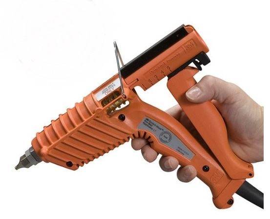

To provide a couple of real world data points:
1) A standard hot glue gun, professional grade, is rated 80 watts. It draws a little over 100 watts cold, which drops to about 30 watts when hot. Standard hot glue is injected at about 130 deg C.
2) High temperature hot glue is injected at 196 deg C. A 3M Hot Melt Applicator TC (shown below) designed for 0.44 g/sec flow at 196 deg C is rated 150 watts, and draws 140 watts according to my Kill A Watt power meter. You have four times this flow and a higher temperature. You will need more than 140 watts.
And some practical realities:
1) Winding Nichrome wire on a copper tube will create a short circuit.
2) The gun shown above costs $200. For that price, you get something that is safe to use. It is safe electrically (won't electrocute the user), and thermally (won't burn the user), and safe operationally (won't overheat and burn the product). It may be hot enough to melt the 220 C plastic.
3) If you can adapt a commercially available hot glue gun to your application (they make other models), it will be far cheaper than designing and building your own. Here is a link to 3M hot melt applicators: https://www.3m.com/3M/en_US/company-us/all-3m-products/~/3M-Hot-Melt-Applicators/?N=5002385+3291079629&rt=rud. There are other manufacturers.
