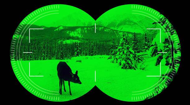

A different type of NV is based in light amplification. This does not require any artificial light, since it's just amplifying the (visible) light already present. Though this does not work in complete darkness. On the other hand, this has no distance limits.

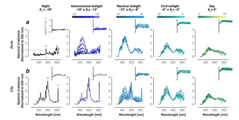

a) Light amplification based NV systems which don't need any artificial light as they amplify the low level (visible) ambient light. Complete darkness = no light to amplify. The ambient light available at night is provided by the start and the moon. The light reflected by the moon has the same spectrum as sunlight. So no NIR is used in this technology. The images produces by NV system are greenish. No distance limits. These systems also detect the NIR available in the nocturnal light. The nature article I found show the spectra of night and twilight (https://www.nature.com/articles/srep26756.pdf):
I read that there are 4 generations on NVD: at gen 4 NVD (gen 0,1,2,3) that don't need an IR illuminator. This article talks about it in detail: https://www.degruyter.com/document/doi/10.2478/s11772-013-0089-3/pdfb) NV devices that use NIR (700nm -1000nm, correct?): these systems need a source of NIR (IR illuminator) that illuminates the object with NIR (not visible by our eyes). The object then reflects the NIR and the reflected NIR is detected by the onboard NIR sensor. Why NIR? NIR is very close to visible in terms of wavelength when compared to FIR. NIR sources and NIR detector are cheap... I think these are called Gen 0 devices: the unit projects a beam of near-infrared light. Invisible to the naked eye, this beam reflects off objects and bounces back to the lens of the NVD.

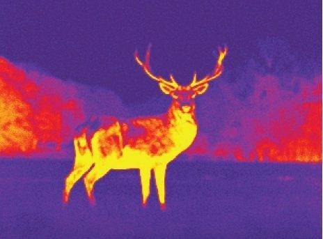

Rive said:
Third type of NV is based on actual thermal imaging.
Sorry, no experience with goggles, but I worked on a machine vision project last year that used an IR camera for crowd analysis, it gave results like @Rive's example photo. I was surprised by the low resolution - 320 * 320 pixels, nowhere near what people expect from even a basic phone camera these days - but to get high resolution images required a very expensive upgrade. What was harder work than we expected was integrating the camera into the NVIDIA Jetson Nano systems that we installed on-premise. But it was proper IR, it did not need an illumination source and it provided additional information to the visual light cameras that the machine learning algo could use to assist with the counting process.
