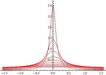

p(r,\theta) = \frac{1}{2\pi}\sum_{n = -\infty}^{\infty}r^{|n|}e^{in\theta} = \frac{1}{2\pi}\left[\frac{1 - r^2}{1 - 2r\cos\theta + r^2}\right].
So I produced the graph but it won't animate.
Code:
MyR = Table[r, {r, 0, 1, .1}];
u[\[Theta]_] = 1/(2*Pi)*((1 - r^2)/(1 - 2*r*Cos[\[Theta]] + r^2));
Plot[u[MyR, \[Theta]], {\[Theta], -Pi/2, Pi/2},
 PlotRange -> {0, 3.25}, PlotStyle -> {Red}, AspectRatio -> 2/3]
Code:
Animate[Plot[u[\[Theta]], {\[Theta], -Pi/2, Pi/2},
  PlotRange -> {0, 3.25}, GridLines -> Automatic, Frame -> True,
  PlotStyle -> {Thick, Red}], {r, 0, 1, 0.1},
 AnimationRunning -> False]
This code doesn't produce any errors or Mathematica complaining but nothing happens when I hit play.

Hi dwsmith, :)
I don't use Mathematica but seeing this question go unanswered I posted this in the Google Mathematica group. Here are the replies.
Kind Regards,
Sudharaka.Reply 1:
myR = Table[r, {r, 0, 1, .1}];
u[r_, \[Theta]_] = 1/(2*Pi)*((1 - r^2)/
Plot[Evaluate[
Tooltip[u[#, \[Theta]], #] & /@ myR],
AspectRatio -> 2/3,
Frame -> True,
Axes -> False]
Plot3D[u[r, \[Theta]],
{r, 0, 1},
PlotRange -> {0, 4},
AspectRatio -> 2/3,
ClippingStyle -> None]
Animate[
Plot[u[r, \[Theta]], {\[Theta], -Pi/2, Pi/2},
Frame -> True,
{r, 0, 1, 0.1},
Manipulate[
Frame -> True,
{r, 0, 1, 0.01, Appearance -> "Labeled"}]
Reply 2:
You need to define u as a function of two variables.
u[r_,theta_]= ...
as in
u[r_ ,\[Theta]_] = 1/(2*Pi)*((1 - r^2)/(1 - 2*r*Cos[\[Theta]] + r^2));
PlotRange -> {0, 3.25}, PlotStyle -> {Red}, AspectRatio -> 2/3]Then
Animate[Plot[u[r,\[Theta]], {\[Theta], -Pi/2, Pi/2}, PlotRange -> {0, 3.25}, GridLines -> Automatic, Frame -> True, PlotStyle -> {Thick, Red}], {r, 0, 1, 0.1}, AnimationRunning -> False]
