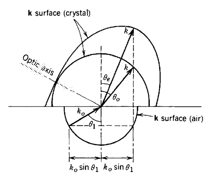

Consider reflection and refraction of a plane light wave on a vacuum-uniaxial crystal interface.
As it is well-known, when the optical axis of the uniaxial crystal is parallel or perpendicular to the normal vector of the interface, there is no double refraction for a natural (unpolarized) light at normal incidence.
For the optical axis neither parallel nor perpendicular to the normal vector, it seems to me, also there is a no-double-refraction case, where the incident angle is set so that the refractive waves (both o-ray and e-ray) propagate along the optical axis. However I failed to find any textbooks which presents such a case. Did I miss something?

Looking at the picture below, it seems possible to realize an arrangement such that ke//OA, Se//ke, and ko//ke. Namely, rotate the OA clockwise till it coincides the vector line of ##k_o##.
I think you are right. In fact, by directly drawing a common tangent line of the circle and the ellipse, cutting the crystal so that the cutting line intersects with the common tangent line, and drawing the normal of the cutting plane, we can get the refractive angle --- Huygens principle.
I am just curious, why such a simple but important interesting case is not presented in popular textbooks.

I thought that picture I posted answers your question without resorting to papers. I don't know if there are any paper on this subject though.

You can find the picture in "Fundamental of Photonics" by Saleh and Teich.

Why do the authors have to make specialized sections for each possible outcome of a certain phenomena the chapter is discussing about? How thick do you think the book will be if such idea was implemented? Sometime, the reader is expected to deduce their own conclusion upon certain phenomena which is not explicitly mentioned in a literature but the basics of which are already elaborated. This is the case with that picture. In the book, the picture comes with the explanation of how to interpret the geometric meaning of the indicatrix at the interface of different media, which eventually leads to that picture. If you know how to read that diagram, you should be able to infer that it's indeed possible to have no-double refraction even if the ray is not perpendicularly incident on the interface and the OA is neither parallel nor perpendicular to the interface. Now, let's define ##\alpha## to be the angle between the OA and the interface. That picture suggests that for ##\alpha < 90^o-\theta_c##, where ##\theta_c = \arcsin \frac{n_{air}}{n_o}## is the critical angle between the two media, the situation of no-double refraction cannot occur regardless of the incident angle. This might be the case in your experimental attempt. It might be that the angle ##\alpha## is such that it doesn't allow you to have observe no-double refraction.

...If you know how to read that diagram, you should be able to infer that it's indeed possible to have no-double refraction even if the ray is not perpendicularly incident on the interface and the OA is neither parallel nor perpendicular to the interface. ...
