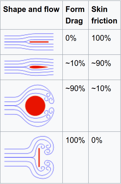

My concern is : When we add viscosity, a term of drag that is called pressure drag, or form drag appears. Like this picture explains :
Is this form drag coming from the fact that, due to viscosity, we have a "stalling" of the flow, and thus the pressure is not symmetrical anymore ? Or is it due to something else I don't understand ?

No, the separation of the boundary layer is not necessary for pressure drag to appear.
Consider an airfoil in inviscid flow at zero AoA. As you said, in this case there's no either friction, nor pressure drag.
When you add the effects of viscosity and the boundary layer, not only you now have friction drag, but the presence of the boundary layer also modifies the volume in which there is potential flow. This change is accompained by changes in the distribution of pressures outside of the B.L., and hence also on the airfoil surface, such that when you integrate the modified pressures on the surface of the airfoil, you now have a horizontal component that is the pressure drag.
I hear what you say, but in that case, a flat plate perpendicular to the flow(100% pressure drag) doesn't really have a behaviour with a boundary layer like you describe it, does it?
Correct.
In a flat plate perpendicular to the flow, the B.L. is of course separated. Every time there's a B.L. separation, you can be sure that there's pressure drag as well. A B.L. separation completely changes the pressure distribution around the body.
