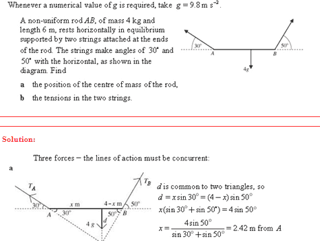

phospho said:I mean, I used a similar method as they're using, but I didn't get their answer at all. Where did the x-4 come from? (I used x-6), also, I got d = (6-x)tan50 and d = xtan(3) solving this to get x = 4.04
