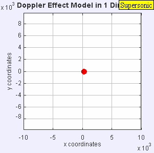

Here is the caption of the animation you posted, taken from:
http://en.wikipedia.org/wiki/Doppler_effect
The sound source has now broken through the sound speed barrier, and is traveling at 1.4 times the speed of sound, c (Mach 1.4). Since the source is moving faster than the sound waves it creates, it actually leads the advancing wavefront. The sound source will pass by a stationary observer before the observer actually hears the sound it creates. As a result, an observer in front of the source will detect
Try different values for f0 and see if it affects f.
That equation isn't correct though. [itex]c-v_{s} \not= 0[/itex], so [itex]f \not= \infty[/itex].
Of course, that equation isn't even valid when you reach Mach 1, so you really can't take anything on Wikipedia as automatically true.
Of course, I may be slightly off in my explanation. Perhaps it is better to say the shock doesn't have a frequency, per se. The higher frequencies generated by a smaller object will still be heard just behind the shockwave and would explain the whistling and the smaller sound of the shock is probably better explained by the smaller pressure wave generated by a small object on account of less air being displaced. My mistake.
Still, any sound source on the object will add to the shock since the radiated sound will be of greater magnitude; it just won't add that much.

Taken from Wikimedia commons.
The animation you linked from Wikipedia is mislabeled. I have informed the author and I hope he corrects this mistake.
The pretty picture labeled "sonic boom" is not a boom and is not really even a shock wave. The oblique wave you see in the picture is properly called a "Mach wave" and is equivalent to an oblique shock in the limit of zero strength (i.e. no turning of the flow and no rise in pressure). You can create a Mach wave in a wind tunnel by roughening the surface of a test specimen and the perturbations in flow will propagate and coalesce, very much like your description of shock waves. However, you would hardly notice the passage of a Mach wave, because there is no static pressure rise such as the rise you get across a true shock.
However, shock waves do not require the coalescence of perturbations to form. An oblique shock will form in a supersonic flowfield pretty much whenever the flow has to turn compressively (i.e. into itself). A normal shock will form when a supersonic flow needs to change speed abruptly without turning. The F-16, famously, has a normal-shock inlet which slows the flow abruptly from supersonic to subsonic to enable it to be further slowed down in the subsonic diffuser. These "true" shocks -- as opposed to Mach waves -- have nothing to do with coalescence of tiny perturbations.
The picture is used in the main article as well:
http://en.wikipedia.org/wiki/Sonic_boom

Maybe you don't have to interpret the circles in the animation as perturbations, bet merely as distance markers that show how fast a perturbation would advance. Would this be a correct description of a shock wave, in contrast of a Machian wave? However, the mention of Doppler effect in the labeling would have to go, because it refers to actual perturbations.
I should say first that it is very common to find a diagram similar to the Wikipedia animation in pedagogical developments of shock theory. It has the virtue of making clear the derivation of the Mach angle (arcsin(1/M)). It is probably worthwhile to note that the Mach angle is independent of the frequency of the "beeper" that is producing the waves. Since the paradigmatic Mach wave is a continuous wave at a fixed angle, it's slightly misleading to portray the development of the Mach wave this way -- taken literally, the Mach cone would have a bumpy contour that is the union of all the sonic spheres emitted by the beeper. That is, the Mach wave forms a geometric cone only in the high-frequency limit.
As I pointed out, the Mach wave is the zero-strength limit of an oblique shock. As such, I feel obligated to amend my strenuous objection to the "coalescence" language applied to the development of shock waves. After all, there is probably a way to write down the shock relations in terms of something like a Huygens superposition integral of all the perturbations (not "noise") from the body, essentially a complexified version of the beeper animation. However, I've never run across that treatment. It is more efficient to derive the shock equations from the conservation of mass, momentum, and energy, deploying geometric compatibility relations as needed.
I stand by my assertion that the shock structure is such that any noise emitted by the body is dissipated. There is no "memory" in the shock that would store oscillations emanating from the body. And I still maintain that any perceived "pitch" of a sonic boom is related to the wavelength of the "N wave" that is typical of sonic booms. Small objects like bullets produce compact N waves and large objects like supersonic aircraft produce extended N waves. But the shock waves that make up the N waves are very sharp discontinuities.

Also, it seems you are correct on the Wikipedia thing. Serves me right for hastily pulling something off of Wikipedia without fact checking; a cardinal sin to be sure. Even in the Doppler effect article you linked it had incorrect captions since the equation used is invalid for [itex]M \geq 1[/itex]. Good catch.
It would be the correct description of Mach lines (or waves, same thing), but not a shock. bbbeard is correct in saying that the sound waves do not coalesce into shocks, and the compression waves that do do not propagate in spheres from the objects (roughly) as do sound waves.
boneh3ad said:
However, your definition of a shock has some holes. If your definition was true, then a normal shock would not be possible. For example, there is no turning of the flow in a shock tube. Similarly, in the case of a bow shock, the flow physically can't turn, but the shock forms anyway detached from the surface and then the flow turns once it is slowed by the bow shock. In other words, shocks can form without the need for turning.
Well, happily enough, a normal shock is a "strong" oblique shock in the limit of zero deflection angle. So I would say we are both right. If you look at the oblique shock relation plot,
[PLAIN]http://upload.wikimedia.org/wikipedia/en/thumb/c/c7/ObliqueShockAngleRelation.png/793px-ObliqueShockAngleRelation.png
...Mach waves are the "weak" oblique shocks in the limit of zero deflection (the vertical axis for beta<90), and normal shocks degenerately fall on the point theta=0, beta=90. So, yes, normal shocks don't need turning -- to form, they just need the appropriate upstream and downstream boundary conditions. But they can be analyzed exactly with the oblique shock relations -- after all, an oblique shock is just a normal shock moving sideways. In terms of analyzing sonic booms, though, I think we only deal with oblique shocks with finite deflection angles.
boneh3ad said:
... I still maintain that the shock itself (of any sort) is a coalescence of compression waves. The difference between what I said earlier and what is correct, is that I was attributing the shock to sound waves rather than compression waves. If you look at a flow in terms of a series of discrete compressions (as illustrated by Seitzman at Georgia Tech http://soliton.ae.gatech.edu/people/jseitzma/classes/ae3450/shocks.pdf), you can see that strong compression waves form and eventually catch up to one another, forming a shock. With a continuous compression as in the case of an actual shock tube or a plane or anything else in practice, you would get a continuous compression wave that eventually bunches up, or coalesces, into a nearly discontinuous step.
Yes, I think you can discuss shock formation in terms of the coalescence of perturbations due to the body in a supersonic flowfield.
boneh3ad said:
In other words, yes, you are right that I misspoke in saying it was sound waves. However, it is the coalescence of waves, and while the necessary turning of the flow determines the angle for an oblique shock, it is not the physical basis of the shock. The need to turn into itself would be one reason for the formation of the compression wave that forms a shock, but it is still that wave that coalesces into the shock.
Fair enough. I think of the physical basis of a shock being that (in a streamtube, say) there are two solutions for compressible flow that have the same mass flow, momentum, and energy (provided the subsonic solution's Mach number is above a certain threshold, or there will only be a subsonic solution). So supersonic flow can suddenly and discontinuously change to subsonic flow without violating any conservation laws. Because the entropy rises across a shock, there are no "shocks" that go from subsonic to supersonic. (Of course, a convergent-divergent nozzle will take you smoothly from subsonic to supersonic, albeit without the discontinuity.)
I would submit that flow turning is the "mechanical" basis for an oblique shock. The turning is not as fundamental a part of the picture as the conservation laws. But the reason this is useful is that we have occasion to analyze, say, the curved shocks that form in front of a blunt or rounded body. The streamlines that go through the curved shock turn, and that turning angle is what we use to compute the variation of, say, the static pressure behind the shock, using the oblique shock relations.
boneh3ad said:
I also feel it necessary to point out that it is actually the shock itself that is on the order of several mean free paths in thickness (about 6 if I remember correctly). The shock layer is a different concept where, at very high mach numbers in the hypersonic regime, the shock comes so close to the surface of the object that you end up with strong entropy gradients close to the wall and in the boundary layer.
True.
